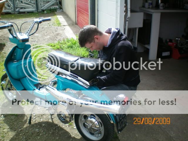

Here's Dan hard at work on the Vega on Saturday
