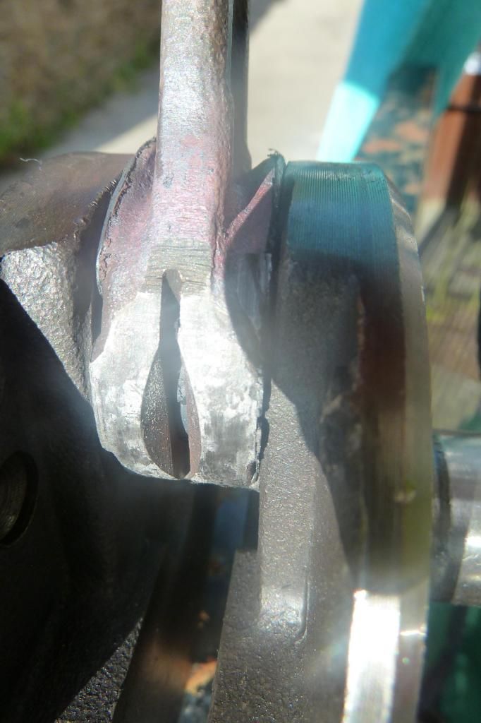

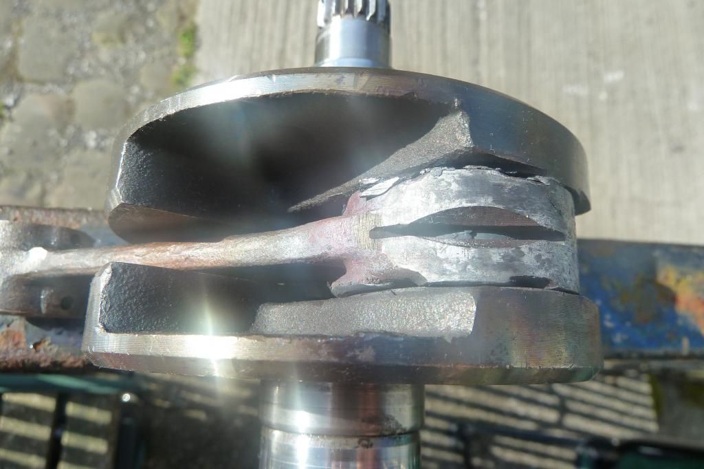

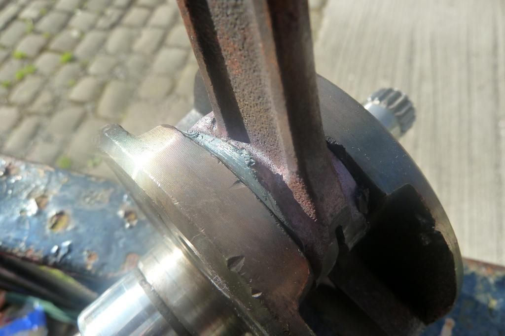

Pictures of the crank for those that are interested -

diesel
Posts: 201
Can the mechanics amongst us tell by looking at those photos whether or not the big end was adequately lubricated?
Adam_Winstone
Posts: 1693
I've seen so many of the standard SIL big end bearings break up or be that nasty dull grey that poor quality bearings go just before they break up, that I don't think that poor lubrication is the cause in most SIL crank failure cases. In the 80s/90s at least one dealer used to strip out and replace all of the factory cranks on the new SIL GP200s that he used to sell, simply because the rate of warranty failures didn't make economic sense, let alone the bad reputation that goes hand in hand with such failures.
The most I've known out of a standard SIL GP200 crank is 6000 miles and the crank on that had a nasty dull grey bearing when inspected and wouldn't have lasted long. If you manage to get more then this out of a standard SIL crank (not the SR uprated bearing item) then I'd suggest you're probably not riding it hard enough! (lol)
Adam
PS - Don't bin that crank though because SIL webs make for excellent cranks when fitted with a decent replacement bearing and rod (towards the top of the crank tree).

diesel wrote:Can the mechanics amongst us tell by looking at those photos whether or not the big end was adequately lubricated?
Something I thought but the engine would also signs of lack of lubrication too. They share the same oil/petrol mix.
I'm with Adam, poor bearings.
