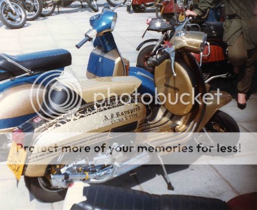

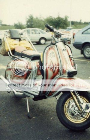

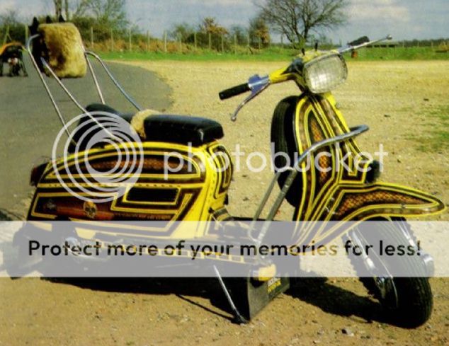

..and just to cap it all off a quick section on great reverse pull heroes of the past. from the days when scooter enthusiasts were "scooter boys", every 6 volt bump start chancer had no rear tail light and adiquate riding gear was the levis denim in winter and a sleeveless clash t shirt in summer. Hail Frank!
