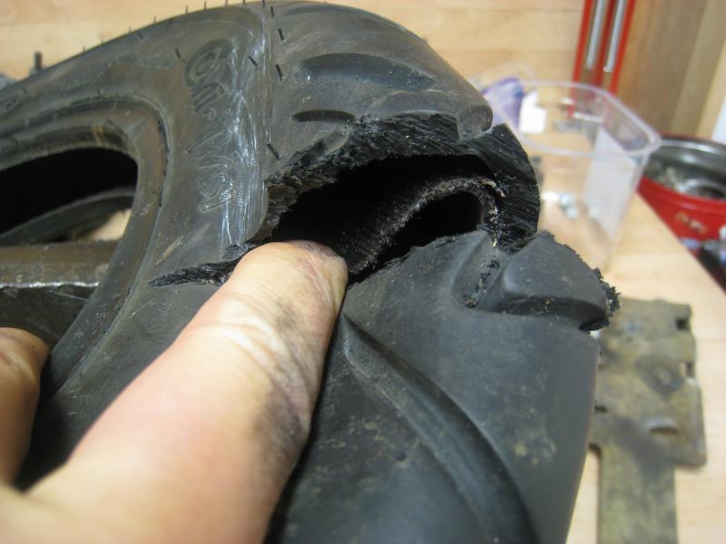

Failed Conti Twist from front wheel of a PX, cut open to see the extent of the problem. The delamination was around 20% of the circumference of the tyre - one massive blister and on a wheel used with tubes.
I don't believe that it was overheated, nor am I satisfied with tyre companies who say 'we'll look into it', give out some free tyres and don't say another word.
I'm sure overloading/underinflation/overheating is a factor in the majority of failure cases, but not all.
