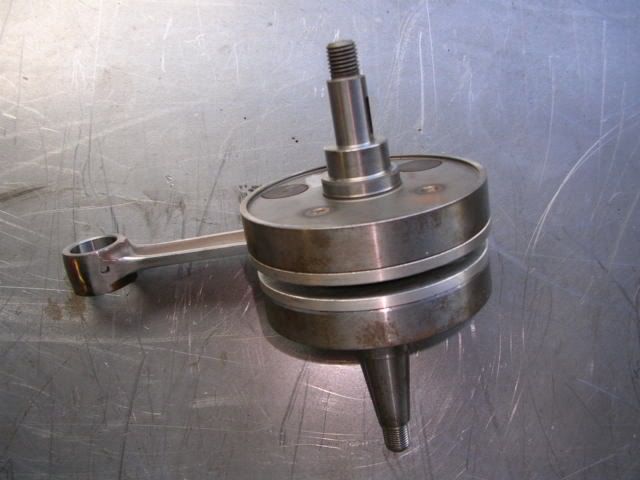

Full circle P2 crank modified for T5 casings
