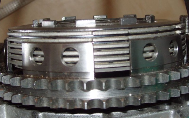

Bilko, some thoughts, the bottom steel has the ears bent up, is the friction area still fully flat? I use a Bedspeed, modded /welded, deep pressure plate and a Foxhat spider to get a working 6 plate clutch with the crown wheel like yours, you can't be that far off, it must just be a detail modification to get it working and save you a lot more money. Ian

Two things from the pic Bob. Fit a spacer between the top of the presseure plate and the cltch compressor bolt. Mines the same and your not compressing fully.
Secondly the steel pictured with the bent up tangs check that these are longer than normal ones. It may be the pic but to me they look std length and if so the bottom steel will drop underneath the spider.

Just a guess, and probably not what's happening. But maybe the bottom steel is kicking off center allowing one of the tangs on the bottom metal plate to stick once the clutch is used under use. This will not normally show up when your building the clutch prior to actually using it.
But this wouldcause the clutch to slip as you have mentioned.
Possibly a foxhat spider might proove or dissprove this is happening as it is far deeper and allows a standard flat steel to be used instead but will also work with your modified lower steel plate.
Just a thought, probably somthing else altogether.
Ps you could just leave out the lower steel and one cork to see if the other bits are working together. You will have reduced spring pressure and less friction area but if the clutch free's off and engages it would help diagnose the fault as the bottom plate tang length or spider profile for the depth of clutch being used.
Not suggesting u use the clutch like this just to check the function of the parts and where the problem lies.

J1MS wrote: Possibly a foxhat spider might proove or dissprove this is happening as it is far deeper and allows a standard flat steel to be used instead but will also work with your modified lower steel plate.
That was my feeling as I think Cam Lam now supply this kit with a Tino billet spider?

TRY SCOOTSRS , THEY DO THERE OWN 5 PLATE BILLET SPIDER AND AT £20 IS WORTH A TRY ,HAD ONE POSTED TO CHECK IT OVER AND WAS FINE !!!!!!

I had originally bought a spider for "5-6 plate clutches" and it was too long. Here it is or was, so to speak.

is the spider level with the underside of the crown wheel ? its sticking above the crownheel possibly 3.5 mm ?????????????????????????
