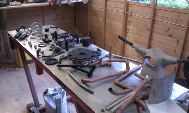

I'm in the process of stripping it down for powder coat and paint. There is a little powder coaters not far from my house. He seemed very keen to undertake the work. I suppose it makes a change from doing council signs and drain covers. He has no qualms with doing ally or filling and rubbing down where needed. I sent the exhaust of to Zircotec to get ceramic coated. I thought that ceramic might be a different alternative to say chrome or bbq paint. I had quotes of £200 ish to get chrome. But nothing had prepaired me for the phone call from Zircotec. To do it in black satin hot plasma sprayed ceramic they came back with £365 + vat + p+p gulp. So I have gone for their budget finish which came in at £200 ish, still a bit expensive but comes with a lifetime garantee. More soon.
Got the exhaust back in the week, Zircotec have done a real nice job. It has a slightly textured finish to it which will match the powder coated frame if I can find someone to do it.
A small update, I have got all the bits that the powder coater wanted to do back on Friday. The rest I will do myself now, I have made myself a small oven to do the baking. Also I bought a sand blaster and a powder coating set up.
The box of small parts left to do.

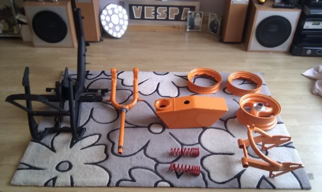

Got my home made oven working and have sand blasted all the remaining parts ready to powdercoat today. I will post up some pictures later on today hopefully.

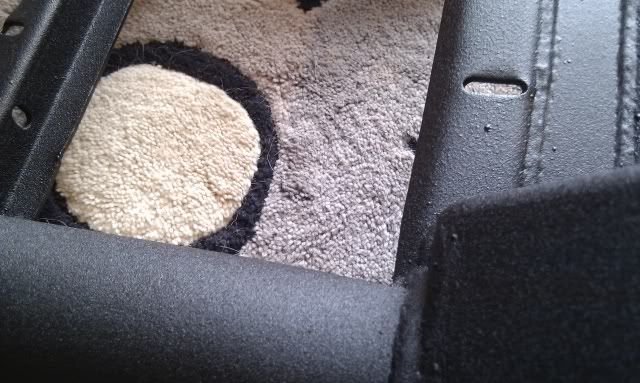

Diy powder coating went really well, Grit blasted all the parts, de-greased them in some acetone then hung them in the oven to pre warm and to out gas a little. On with the powder then back in the oven for 10 mins at 180'c. Got about 75 % of the parts done, easyer that I thought.
