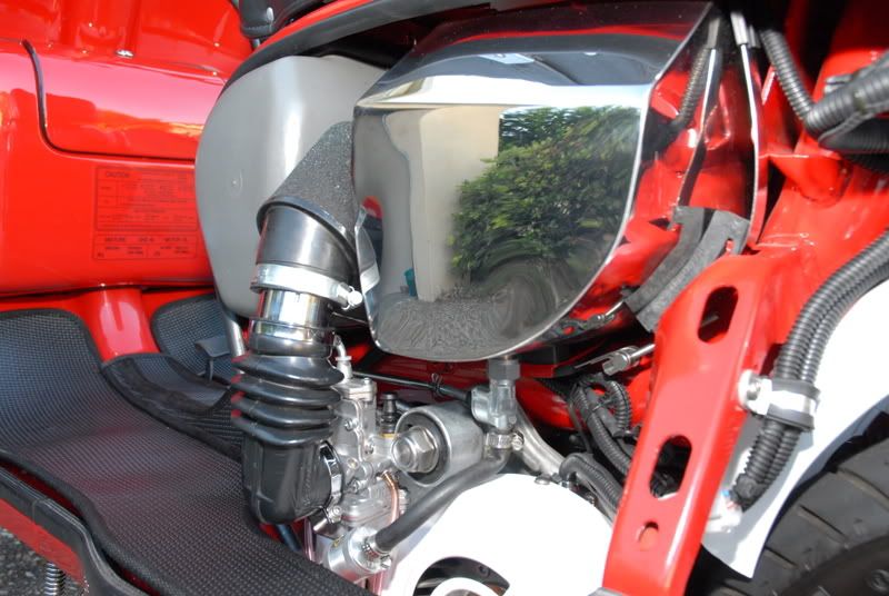

Have a look in the fuel pipe and filter in carb. Look in bowl too. See if any debris in there.
red ghost
Posts: 545
Main scooter: lambretta gp150
My stainless tank hasn't caused me any troubles....
Looks like it needs a clean n polish. :lol:
lifes a drag
Posts: 174
you mite wanna sort that kink out in your pipe aswell mate ;)
J1MS
Posts: 1153
lifes a drag wrote:you mite wanna sort that kink out in your pipe aswell mate ;)
Cam Lam do a nice rear facing fast flow tap that might not leave a kink in the fuel pipe.
