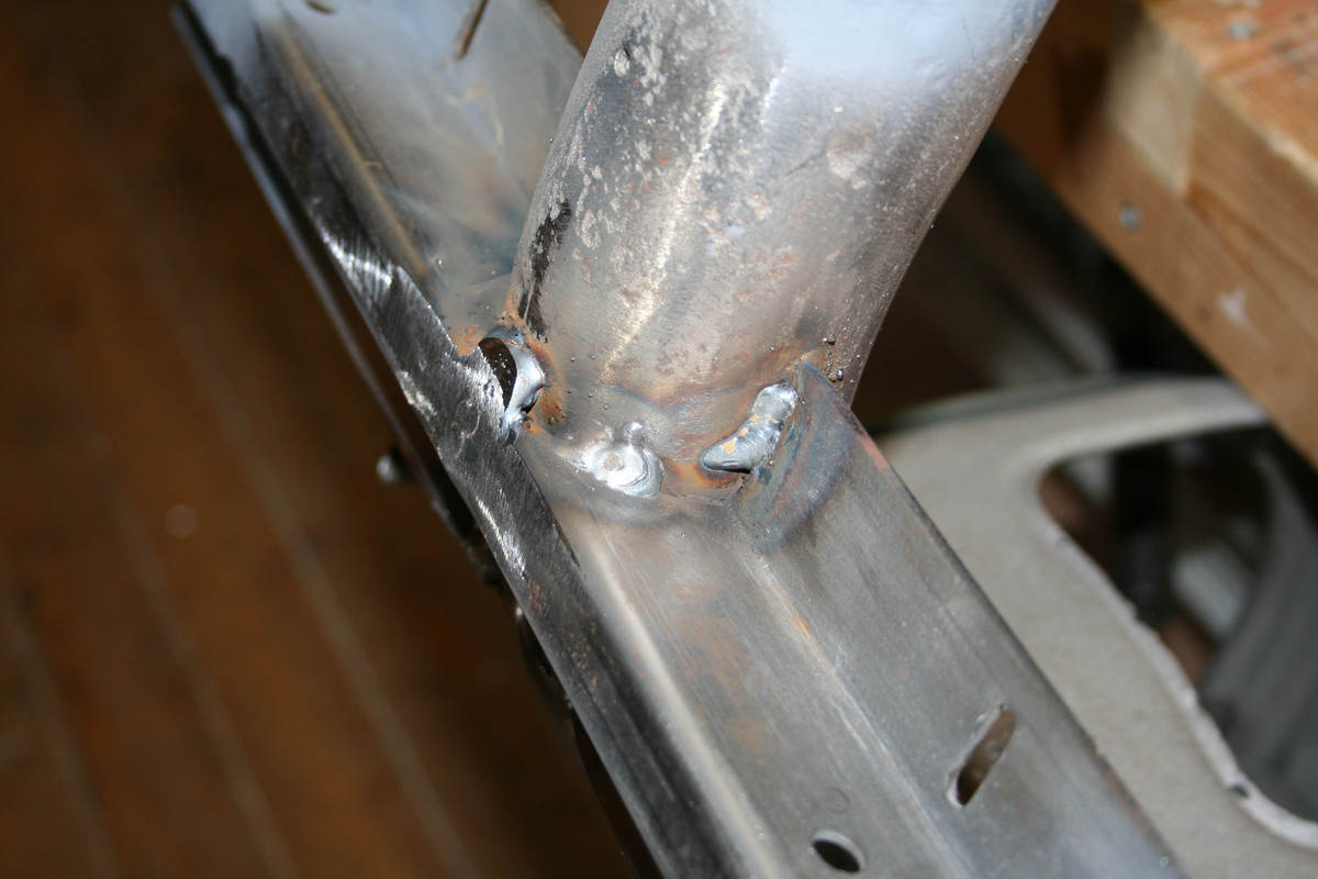

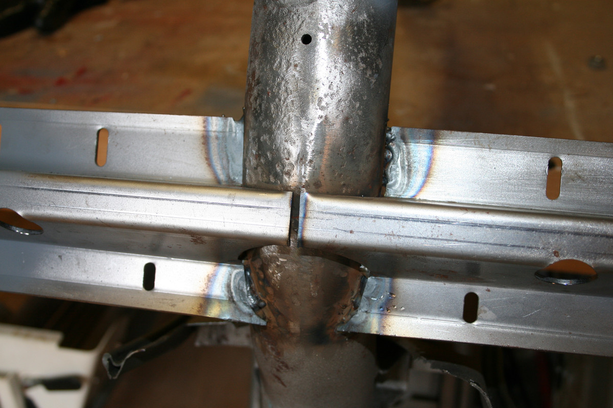

Even though main crossmember was welded on on a jig, the welds had pullet it up a bit and so it wasn't level, so turned it upside down and cut a slot in the bottom and clamped it down and re-welded.
Filled the gap a bit at the front as well as reinforcing the main x-member welds from below - my welding is crap. It's a bit like spraying silly string...

But it's now spot on - front struts and rear stays are original as far as I can tell, hence not wanting to chop it about too much.
