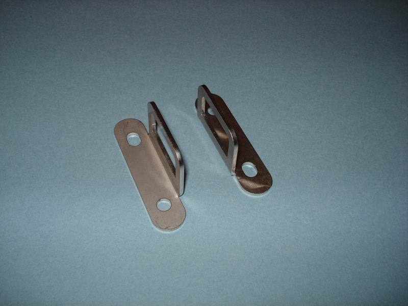

Its good to see that you're all smartly turned out in clean shirts.
Those floor strengtheners are a good idea, the floor of my Rally is bent to $%^&. I've now fitted a plate with a built in hook for a bungey. Very useful when combined with a floor mounted rack.
