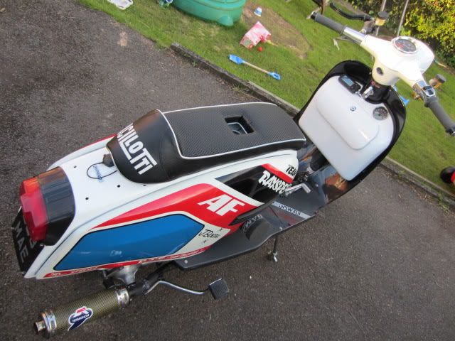

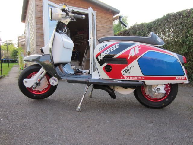

wax wrote:I have had a Dyno run at Diablo Moto since i last posted (Thanks Alan, Great work as always!) and got an MOT (and a new seat ;)). It did 34 BHP, which is slightly down on last time, but the jetting is much richer, so it should be more reliable now. I ordered one of those Readspeed 8 Stage CDI's and it ran for 60 seconds before giving up? So we had to settle for static timing in the end. Following the usual shake-down, when anything that is not Loc-Tighted just falls off, i finally got to have a blast around the country lanes. Grin factor 10! I also managed to take a few better pics......
Nice seat :D can i ask where you got it from and how much it was?is it a bolt down seat or hinge type?

Ello Dean. The seat is from AllStyle scooters, but i just had a butchers and they are no longer on the website. Its a bolt down jobby. Its a bit hard, to be fare, but style first, and all that! Maybe worth a call, if you still want one. It was £180.
