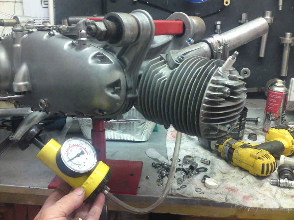

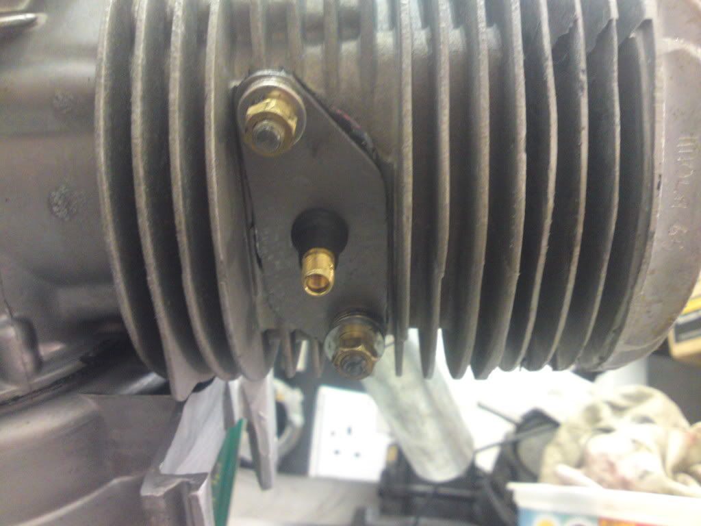

Hi,this is what I do to check for air leaks
Blank off the inlet and fit the spark plug,i then made a blanking plate for the exhaust flange drilled the centre and fitted a rubber car valve and removed the centre so that air can then be pressurised up through the centre via a radiator pump.
Put the motor to bdc.
The motor is then pressurised to 1 bar for a period of 5 mins,if the engines sealed up nicely then you will see no drop in pressure,if the pressure drops then spray some soapy water around the engine to see where its leaking from easy :D

That's a great set up you have there mate. Simple but genius.
