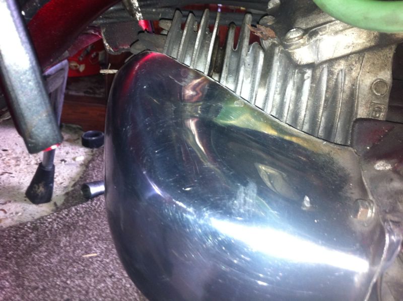

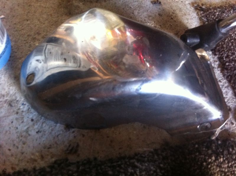

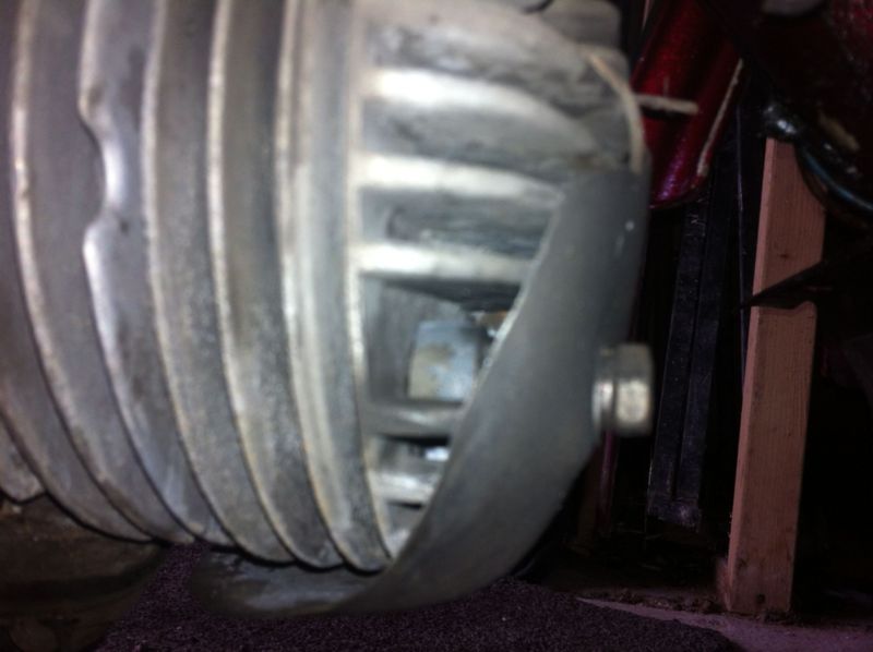

jonashford wrote:handy with the grinder!!!
Cheers, you find that works ok, might give it a go with an old cowling.
