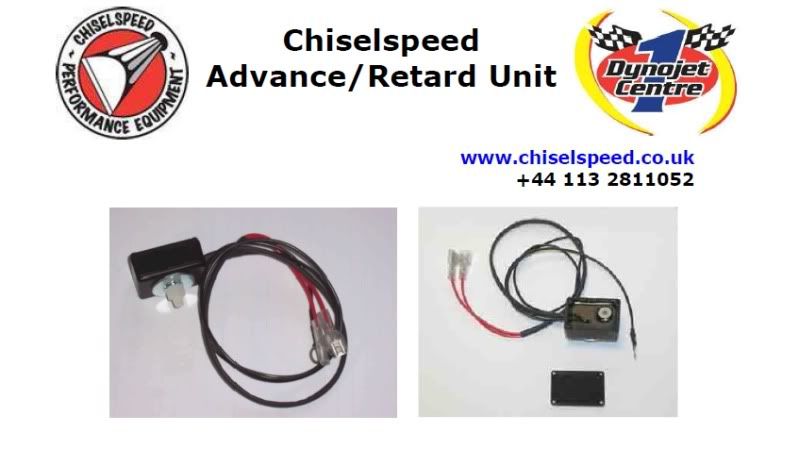

....comes complete with lid to seal it up once set. Keeping dust out and fingers and drivers. :)
For me it is a no brainer, all the Augustos plus a load more all in one box. One price of £80.00, should you decide to have additional tuning or seize ya engine because you set your own ignition wrong and go for an RB instead this box will do the lot!! Just get it re dynoed and find the setting thats right.

Ps the adjustment is by a pot that clicks cleanly into place, theyre a standard item found in allsorts of things. They ai'nt gonna change setting when ya go over a bump. i cant get rubber encased heated grips variable resistors to work for more than one winter what makes this differant?
Can't understand anyone buying an Augusto when this is about to be honest......seen the Italian jobby and is v interesting but a bit low on details on their website IMO. Pictues of the curves, but it would be nice to see actual figures before purchasing one. :D

Come on, one that includes all the Augustos is £80 and a single Augusto unit is £60ish isn't it? Buy the wrong one and its a waste of £60. Its not rocket science.
I'm not biased, its simply a better product, that comes up on threads on here a lot thats all. I use a lot of dealers for different items, hopefully picking the best components from all over.

tony wrote:The chisel one comes into its own because of its adjustability. All these motors of ours are different and to get the best out of them may need varying levels of advance and retard. This is all relative to the tune/pipe etc. Everything affects the ignition. So you may find one motor likes say 20 degrees off pipe but only 12 on and maybe 10 to get over rev. So with an adjustable unit (albeit fairly limited adjustabilty) you maybe able to find the ideal setup.
