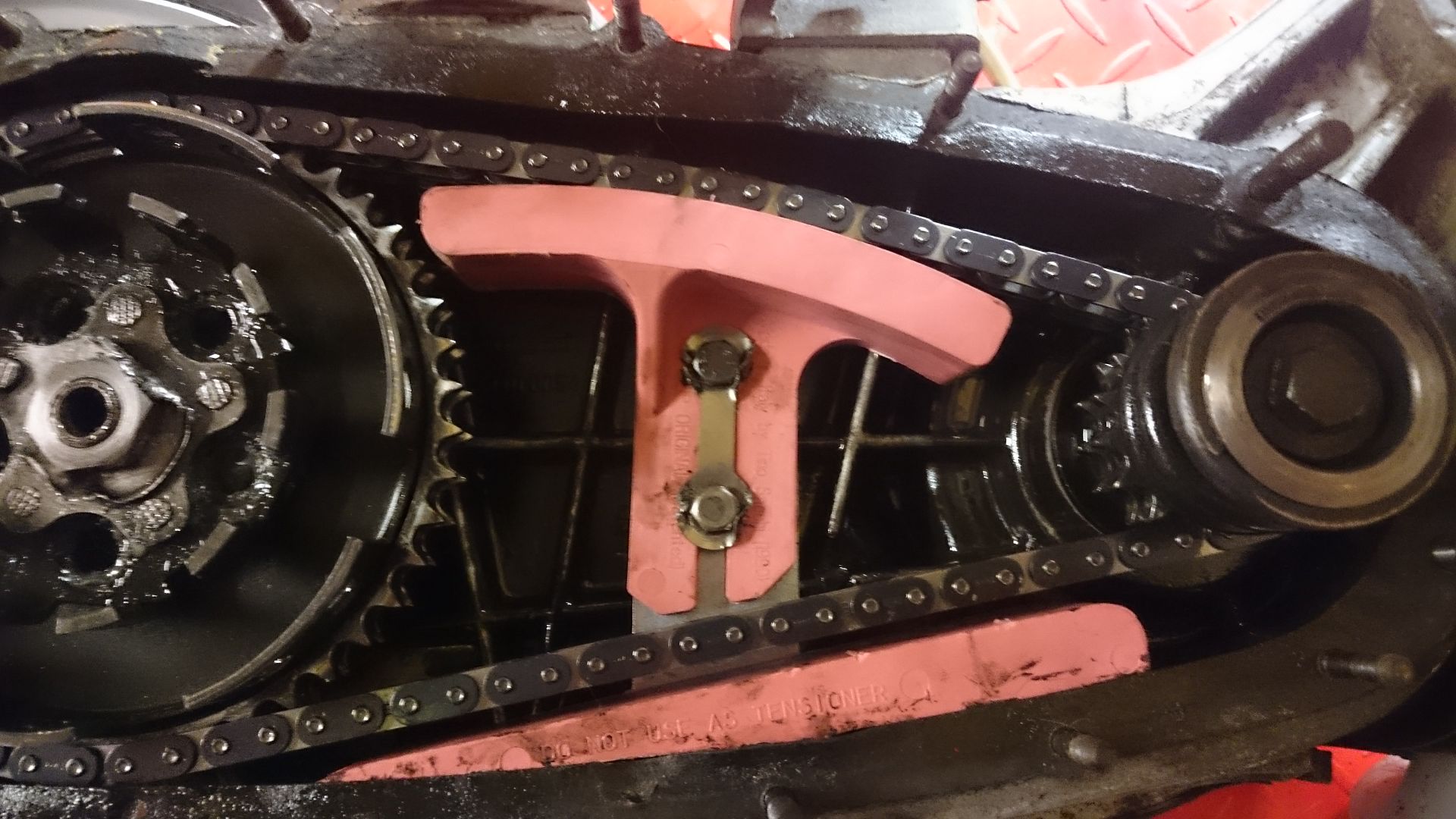

OK, I've fitted the new chain, as well as a pair of Tino chain guides.
The chain seems pretty tight, without any tension from the guides. It's definitely the correct length (80 links, same as the one I removed), so hopefully it's OK.
I had to file a bit off the bottom-left corner of the top guide to stop it catching on the rear sprocket. As seen in the pic, the lower guide doesn't touch the chain, even in its highest position. Is that OK, or should the chain be resting on the guide?
Lambretta LI125 Series 2, Lambretta LI150 Series 3, Lambretta J100 Cento, LML Star 150 2T
bristolmod
Posts: 1741
How strong is that material?
The reason I ask is that the retaining bolts pinch up the guides directly onto the upper plate itself- is there any chance of the plate splaying when the bolts are tightened thus allowing it to move about?
Would some substantial washers or a metal plate under the nuts be a good idea?

I wondered the same thing, but I've tightened them up and there doesn't seem to be any movement. I guess the tab washer plate thingy acts as a kind of washer. If I add an extra washer under the bolt, I'll need to get longer bolts anyway, as the Tino Sacchi chain guides are thicker than the standard ones.

I normally use a stud in there with low tension stud lock to secure it then the guides then flat penny washers then nylocks. In 20 years I've never had one come loose

That looks good - any idea what size studs I need to get?
And I see that your chain seems to be resting on the bottom guide, whereas mine sits a few mm above it (even at its lowest setting) - is that a problem?
