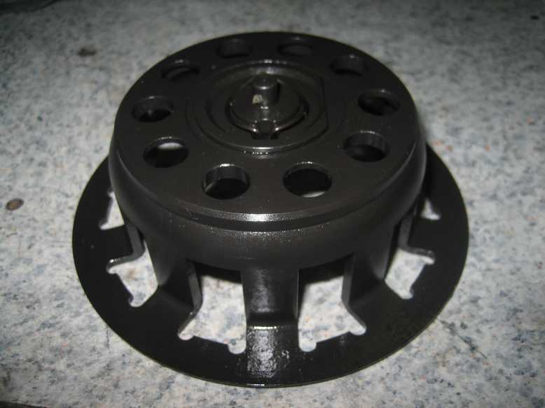

I´m going to put the LTH Liedolsheim clutch in my engine next weekend, i hope it will stand my 35NM of torque..... :twisted:

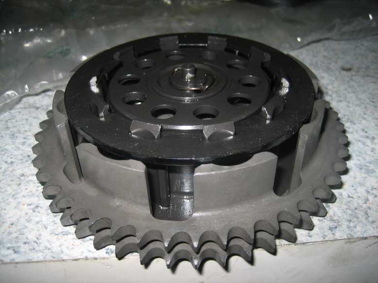

Stampede wrote:I´m going to put the LTH Liedolsheim clutch in my engine next weekend, i hope it will stand my 35NM of torque..... :twisted:
here are some pictures of it, as requested - sorry, no pics of the friction plates, they are already in the oil bath.....

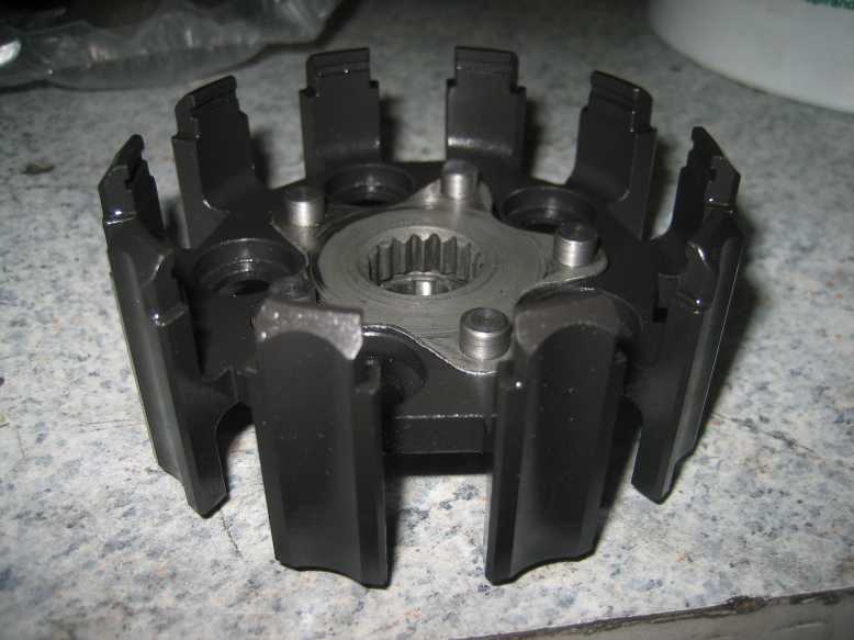

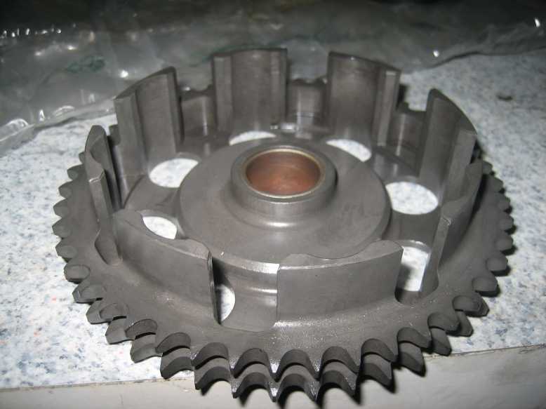

the last one....
any more details such as price and spec please

7-plates sintered metal (from a Honda bike) clutch, fully cnc-machined & hardened!
no spacer needed, of course....
LTH sells them: Clutch
The Tino-Sacchi / CamLam clutch doesn´t stand my long gear ratio with high torque....
nice bit of kit but a bit expensive for me as the readspeed easily copes with the 46bhp that i need it to, 8-)
