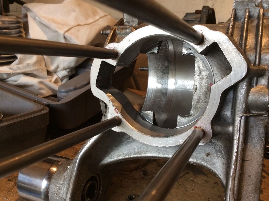

Dremmeled the mag today. Fits like a glove now :D
Started on the transfers but the Dremel bit I was using was going to take me a week on each! Gonna order some new bits and start again. Glad I started though as I've never done anything like this before and just making the first cut has given me confidence to do it :D

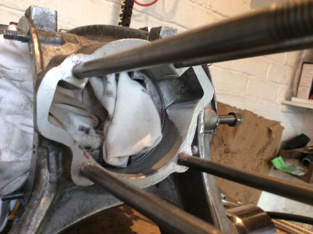

Took at bit of the meat off today, a little bit more on both sides and I'll start with the sandpaper bits then polish :D

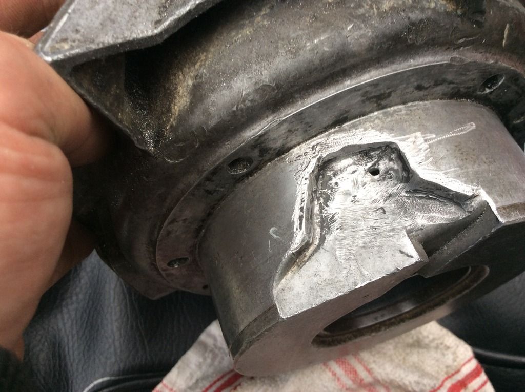

Got a bit carried away! Whoops :lol: glad it was an old one, new one on the way :D

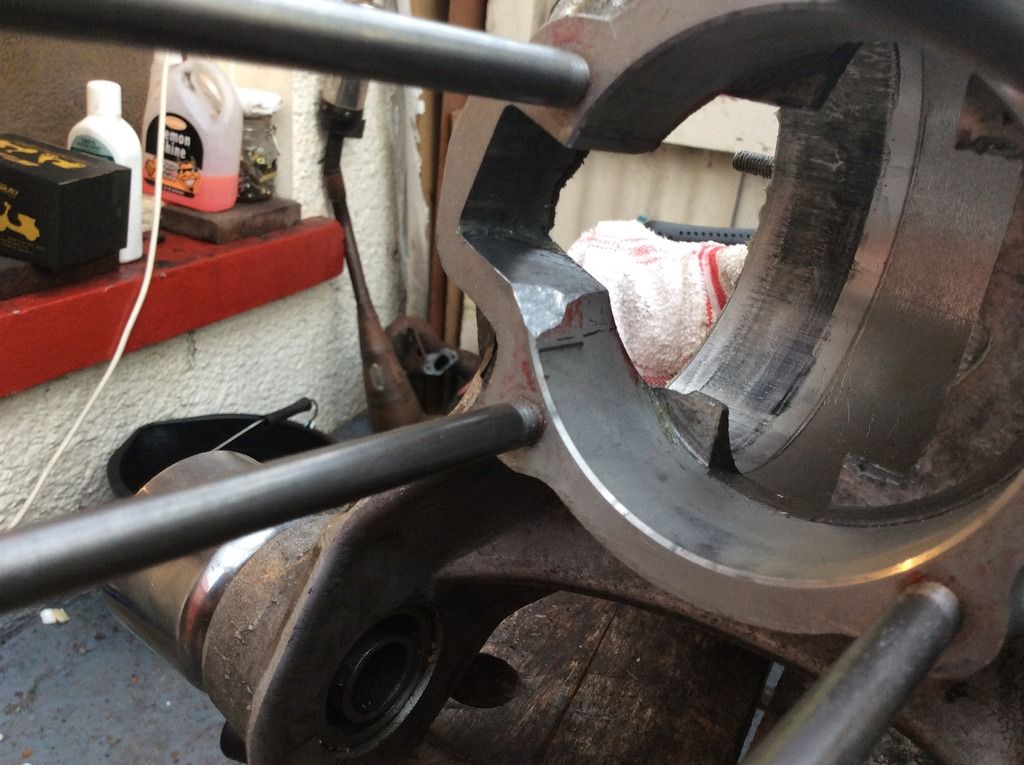

Finished! Tidied up and polished, fit the TS1 gasket perfect :D

HxPaul
Posts: 1110
Location: Halifax,Yorkshire
alanscottj wrote:Got a bit carried away! Whoops :lol: glad it was an old one, new one on the way :D
This is an S1 mag housing,its lubricated by the fuel and oil.The mag housing in the earlier photo is a later one which is lubricated by grease.
alanscottj
Posts: 960
Well spotted! The earlier one had a crack in it, so I started to tidy this one up. Anyhoo, both knackered now, so have ordered a new one this afternoon :D
