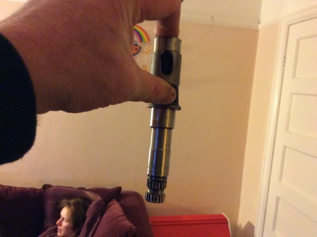

This could be the problem!
Checked out my last kickstart shaft and the one I have in at the mo and they are both bent! I am hoping that this is the problem, surely they must be straight? Both have a definite bend to them. That would answer why when I swapped the shaft a couple of months ago it worked perfect for a while and maybe the new one bent over time and the problem with chewing up the piston starts all over again???
Anyhoo, I am currently waiting for the postman as I ordered a new Tino Saachi k/s/s from CamLam yesterday. Hopefully this one will be straight and remain so
