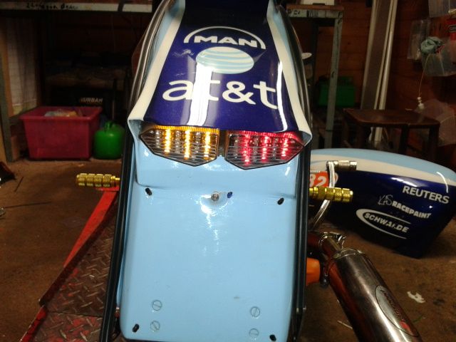

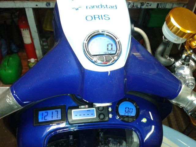

all electrics finished and working plus servo automatic choke
