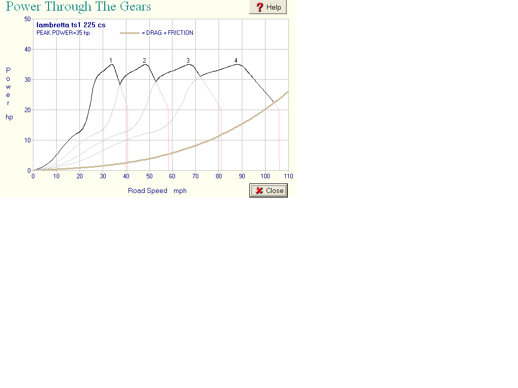

heres a 35bhp ts1 dyno graph thats ran thru the drag race software
it shows on the lower grey line resistance kicking in at 92mph which ties in with sprint results regularly achieved on full bodied scoots

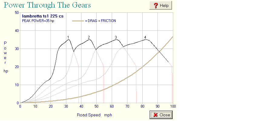

if i add a fairing this is the result which would be similar to lowering the bike/running vega legshields etc as many group 6
mickdale
Posts: 473
interesting to have the drag factor on the dyno results - brings it into reality.
i wonder if a five speed box would keep the bhp up at peak at a slightly higher speed thus keeping it above the drag line for another 5 - 6 mph?
would the 92 mph then go to 97 at 35bhp
then in theory another 3 - 4 bhp and the five speed box would be pushing toward 100 mph?
or am i just hoping

mickdale wrote:interesting to have the drag factor on the dyno results - brings it into reality.
or am i just hoping
I'm thinking the same with an 5 speed box and an RB250. I can see the picture but not the pyhsics. I. can imagine it would would be a bit hairy on an RB250 approaching the ton with the revs up and the engine screaming :o
