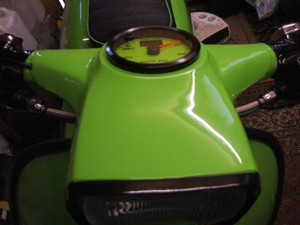

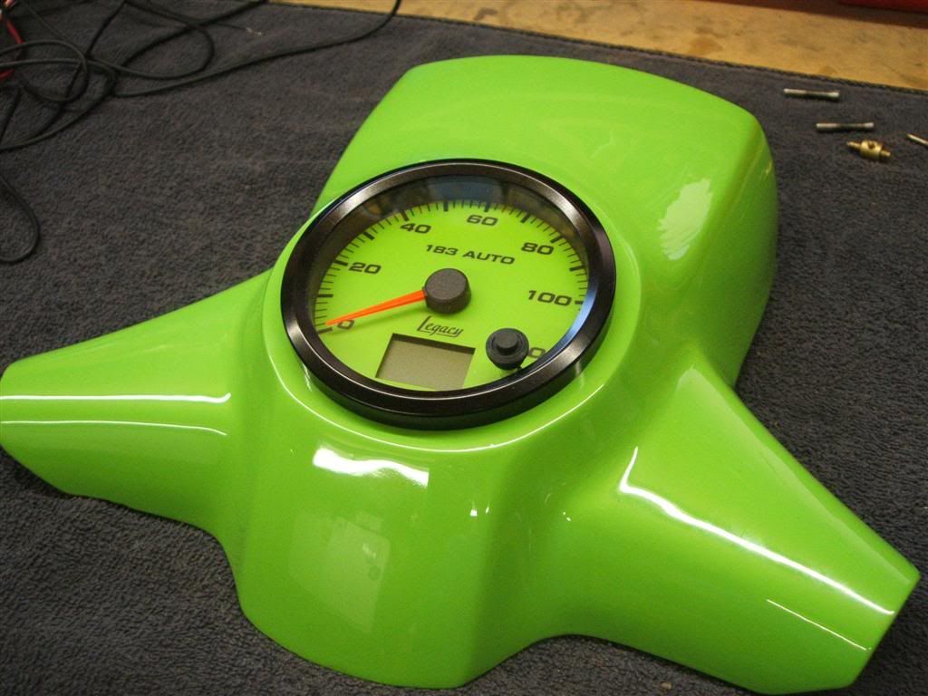

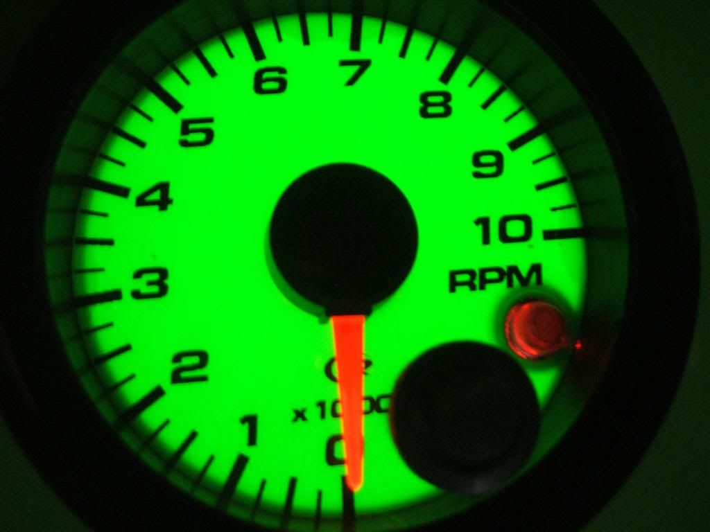

Final top coat done.....

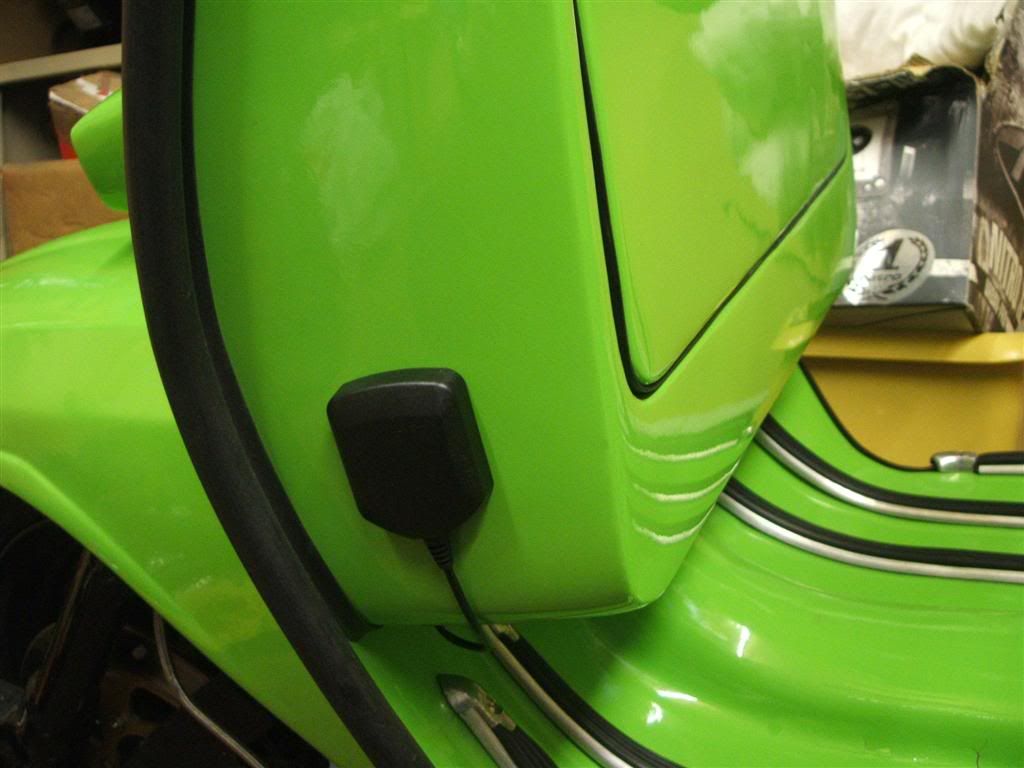

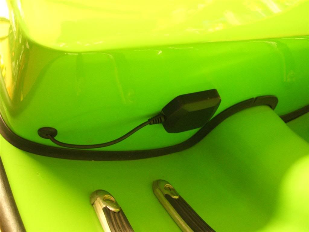

Fitted and connected up...What a doddle, 12v via ignition as no permanent live required and a live via lights for gauge illumination.
The antenna i run down into tool box and out the bottom via a grommet and it sticks magnetically to underside of tool box..
The idea was it would be out the way and if the signal pick up was not good i could just swing it round to the side...

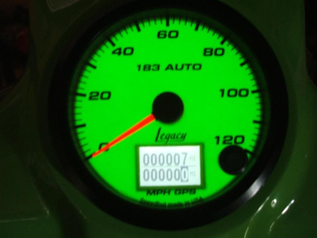

Gauge illumination shots

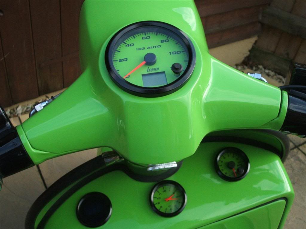

At present the cht gauge looks out of place but it does work superbly.I have spoken to speedhut re a cht gauge so that they will all match but they don't do one a moment but they are working on one at present which will hopefully be due in a month or so..
Been out for a test run today and it works perfectly,needle moves lovely and smooth and not all jerky.Trip works a treat too.So overal well chuffed :D
