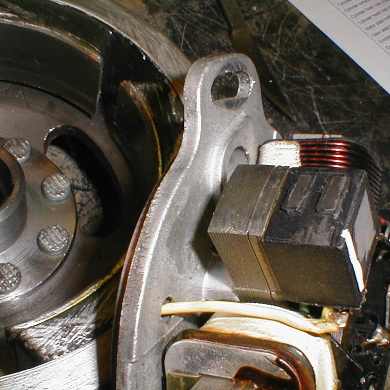

eden wrote:fked low tension coils normally result in the engine not running at all, fked pickups can give all sorts of symptoms.
Exactly the same symptoms as last time it went. I put a BGM stator on this time, just got to time it up with a strobe now. I'm concerned that the SIL Flywheel might be buggering the pick ups. The one I took out last night had marks on it from the flywheel. :wtf:

I would be inclined to check the crank for true,but firstly you could colour the flywheel magnet plates with a marker pen refit and spin flywheel to see if it rubs.
