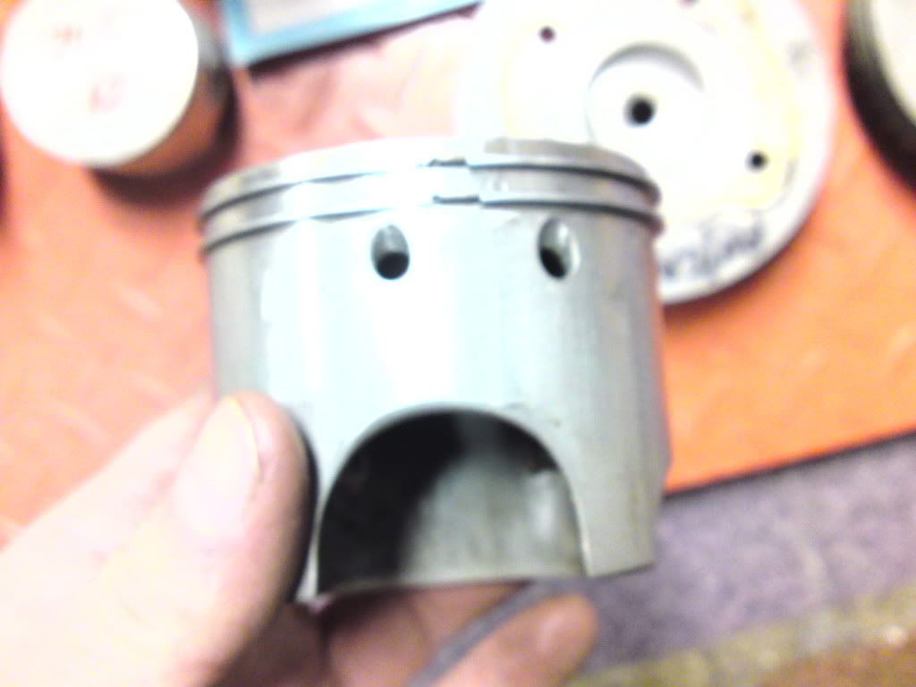

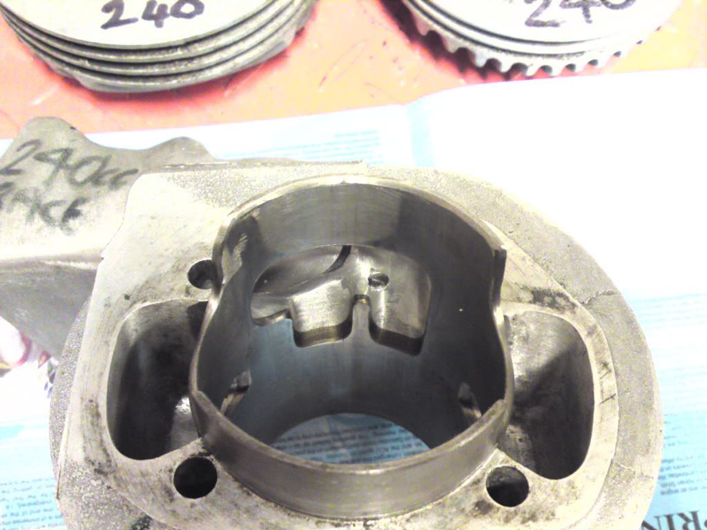

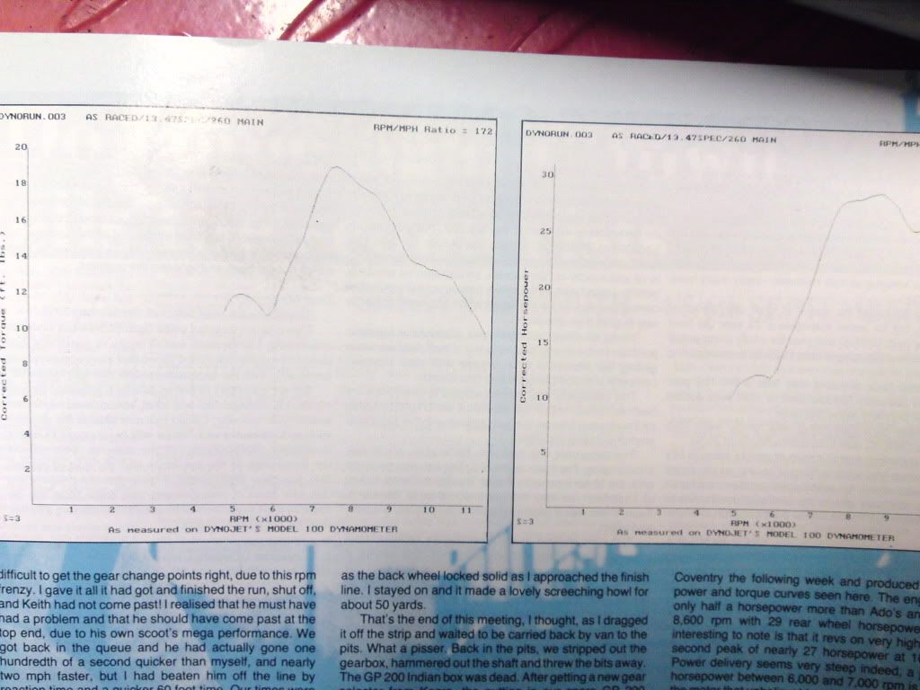

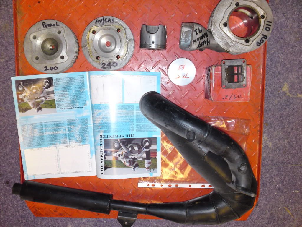

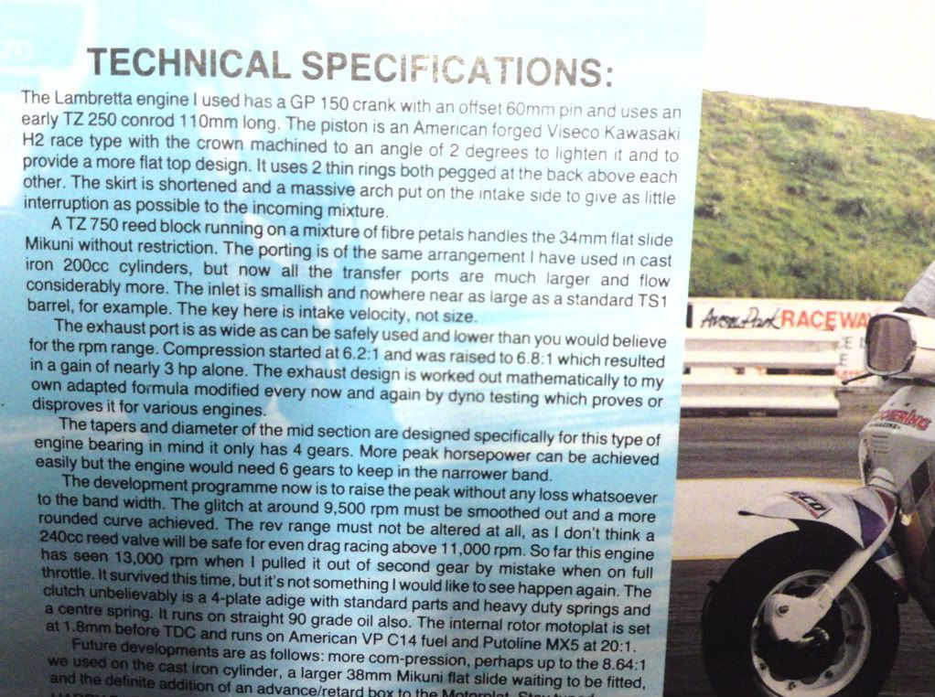

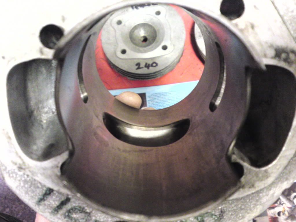

This is the set-up/spec harry used in the write up, I bought the whole top end set up of him years ago and credit to him all a nice peice of kit!!!!! with very little setting up/adjustment this pulled 29 bhp and 96mph @13.4 sec....... I have been meaning to do this motor every year and something else always takes priority....
With proper gearing and setting up this would be one of the few 100mph engines about(arguably),,,,,,,,,,,,,,,,,,,If i go down the route of an RB 250 then i will sell the whole system, so if anyone is seriously interested then pm me for more details!!!!!!
GENUINE REPLIES ONLY!!!!

What magazine is that? Wouldn't mind reading the whole feature.

corrado wrote:What magazine is that? Wouldn't mind reading the whole feature.
There is agood write up about the engine in scootering 1991 got MADNESS VESPA ON FRONT PAGE!!!!!!!!!
