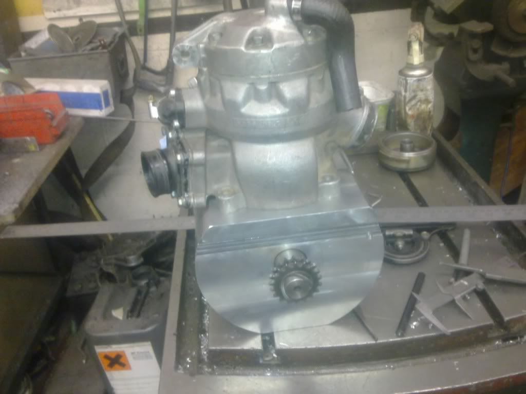

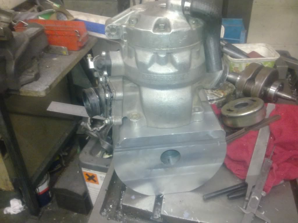

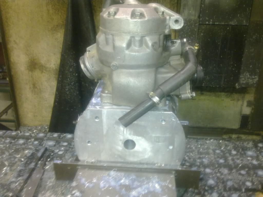

guess what this is

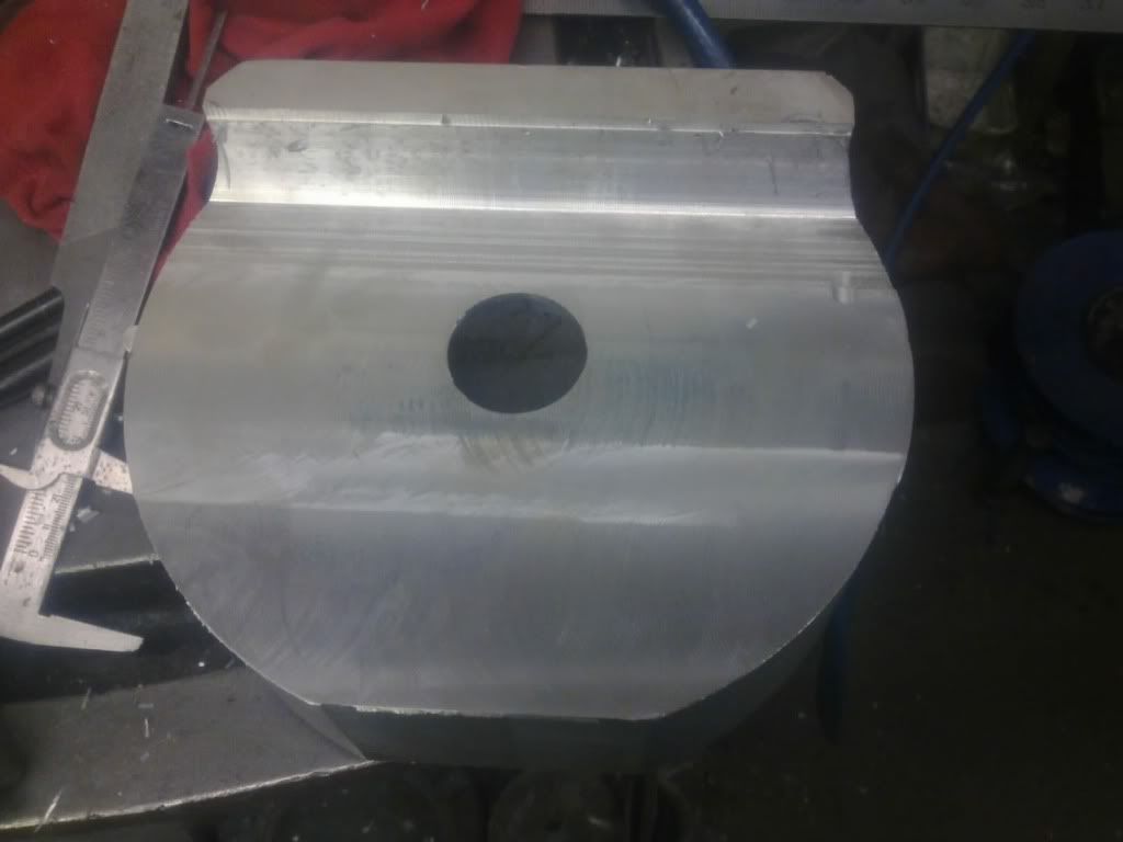

very well and nicely done lads,just wondering have you ever condsidered lenghting the casing for a 12" wheel to be fitted while your at it
twin peeks
Posts: 121
Main scooter: gp200 ts1
Location: swindon
you can fit a 12 wheel to astandard case just depends on tyre profile ,got a130/70/12 on one of me bikes

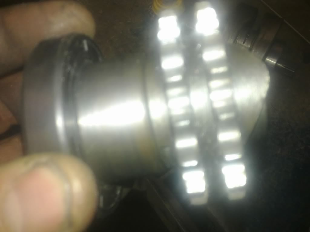

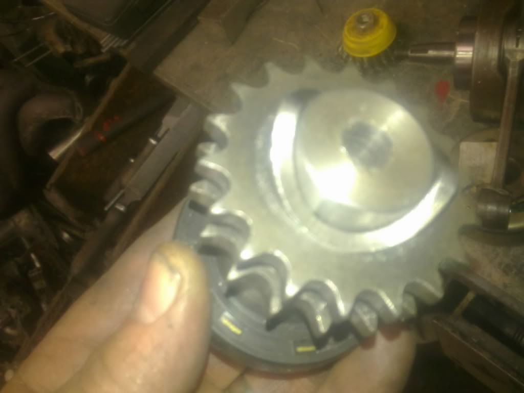

thisitem above is the drive adapter for sprocket

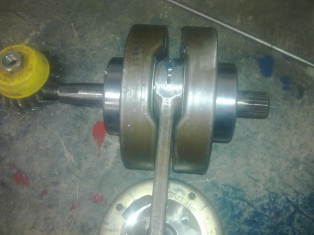

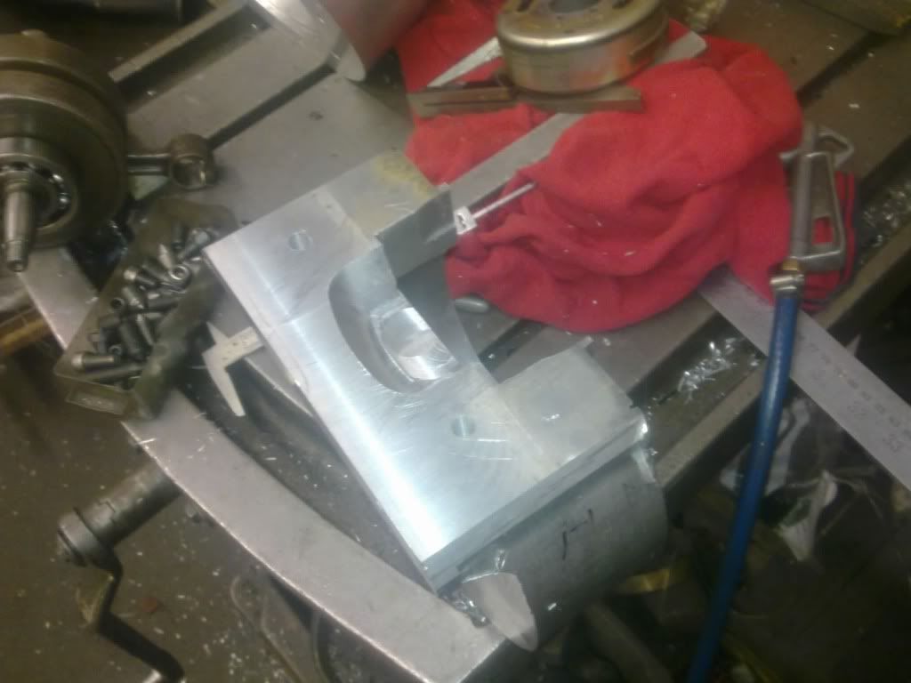

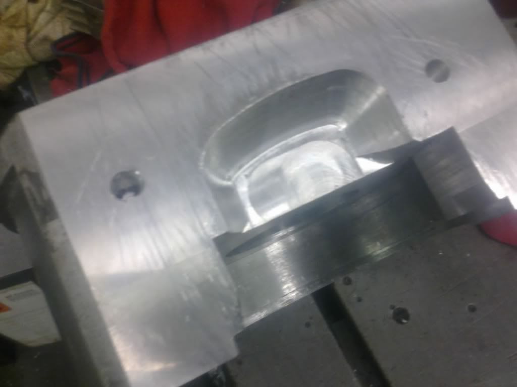

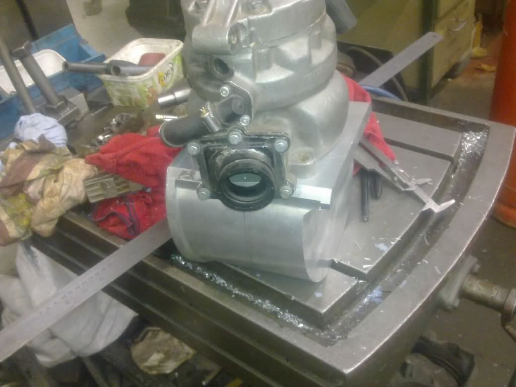

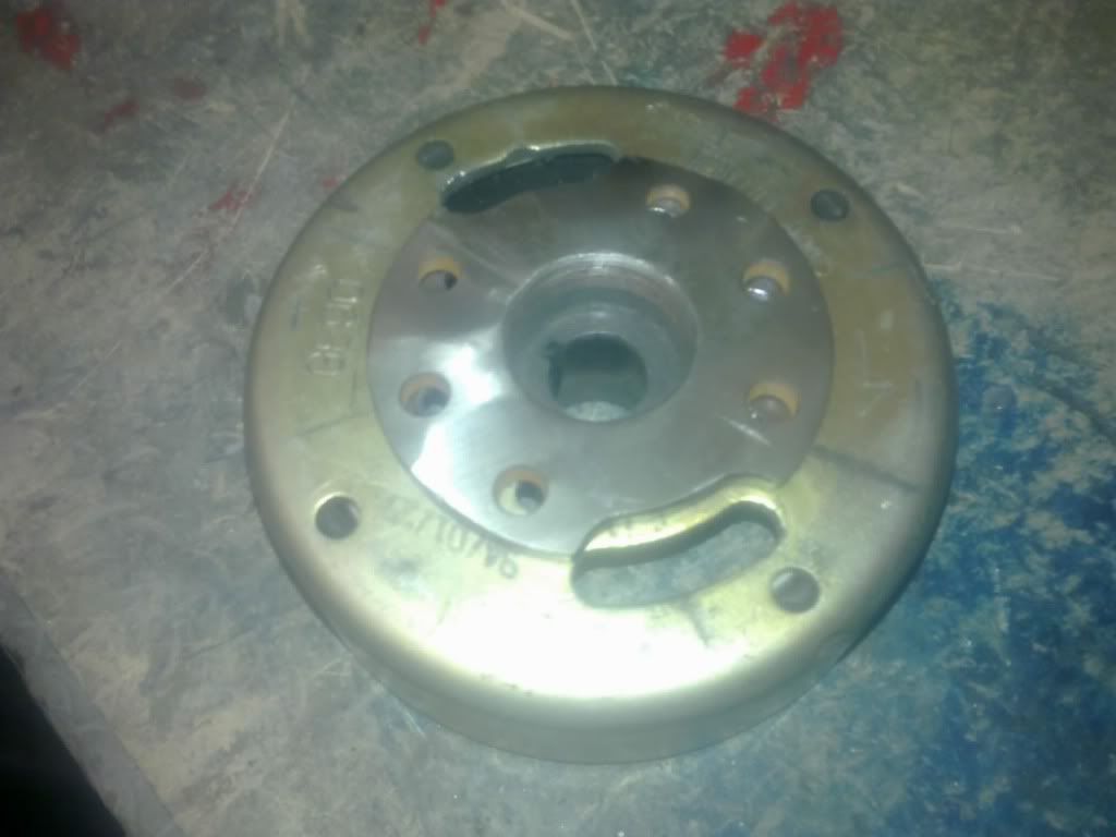

been grafting on this engine this week ,clutch is sorted ignition all done ,water pump parts being made ,will post some more photos soon

8-) Very nice work mate well done....

And all done with pre-war verniers... crafty and nostalgic..
