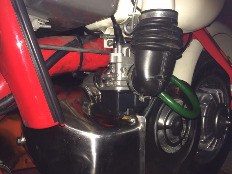

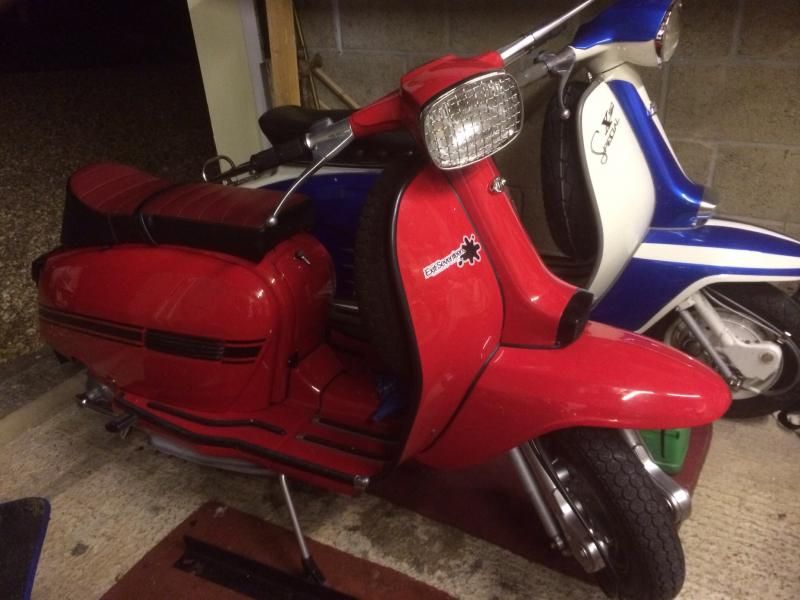

Here's mine, running 25mm carb through air box with BGM exhaust, done about 600 mikes and looking forward to the run to Wollacombe. The one behind has. GT186 kit with 30mm carb and very happy. Thinking of dong a GT225/230 soon.
eden
Posts: 1043
Location: ILCLAND
How does it go running through the air box and box exhaust?
