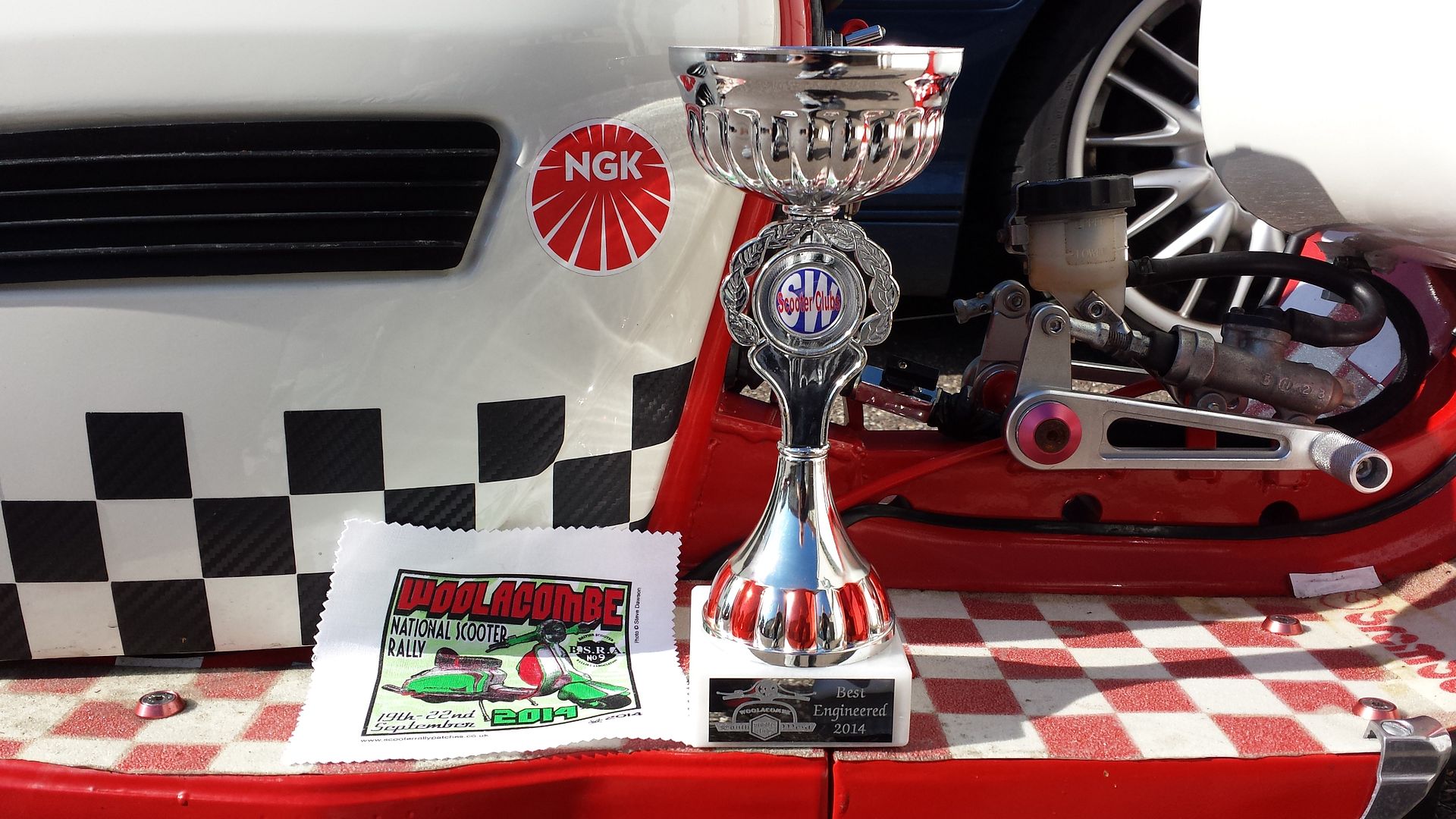

Well its been a long fun journey.
Anyone that read this thread might remember that I started this build after chats and drinks with my mate Vic Saunders. We wandered around the woolacombe custom show at his last rally bouncing ideas and generally having a laugh. I said how i would love to build something worthy of parking in a show.
This weekend i parked in the show area and hope that I did him proud. Had some great comments from people. Overheard chat a out it from people that didnt know it was mine.
Lesson learnt is that its not big enough engine.
I have some ideas bouncing round my head for a rather mental series 2 with loads of custom car and bike influences.
