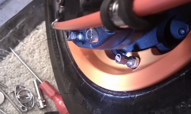

Here you go lammer205 and corrado, the rim fits perfect on their hub/backplate. Also the valve stem misses the brake caliper easily.

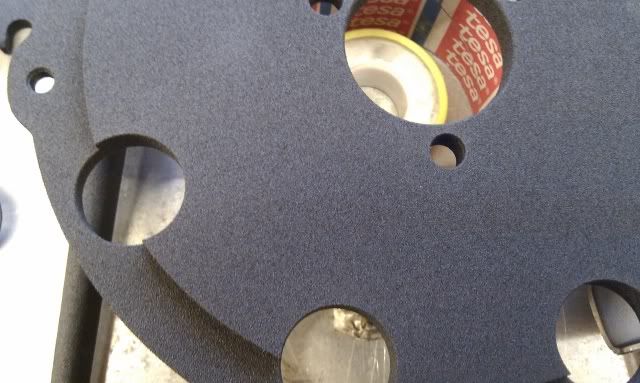

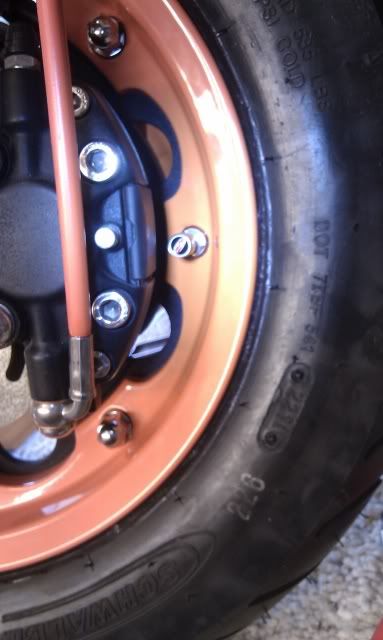

I might be wrong, but doesn't that have the same gap as shown on the standard hubs? How well does the centre plate fit on the other side?
These are some more pictures of the SIP rim...
They fit like this to Innocenti and pattern rear hubs and Servetta, Innocenti and Stoffi disc brake front hub. Much better, no?

The hub/backplate is machined down to take the wheel rim. The wheel rim fits perfect and is perfectly centred.
Also another thought on this, sent with the new rims is a set of special flat washers that are machined to fit in the recess in the rim and the outside of the stud. The rim surely can only be perfectly centred, this and they are held in place with good quality spring washers and specialy made deep wheel nuts.
