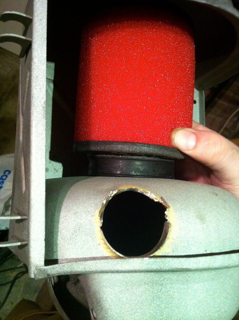

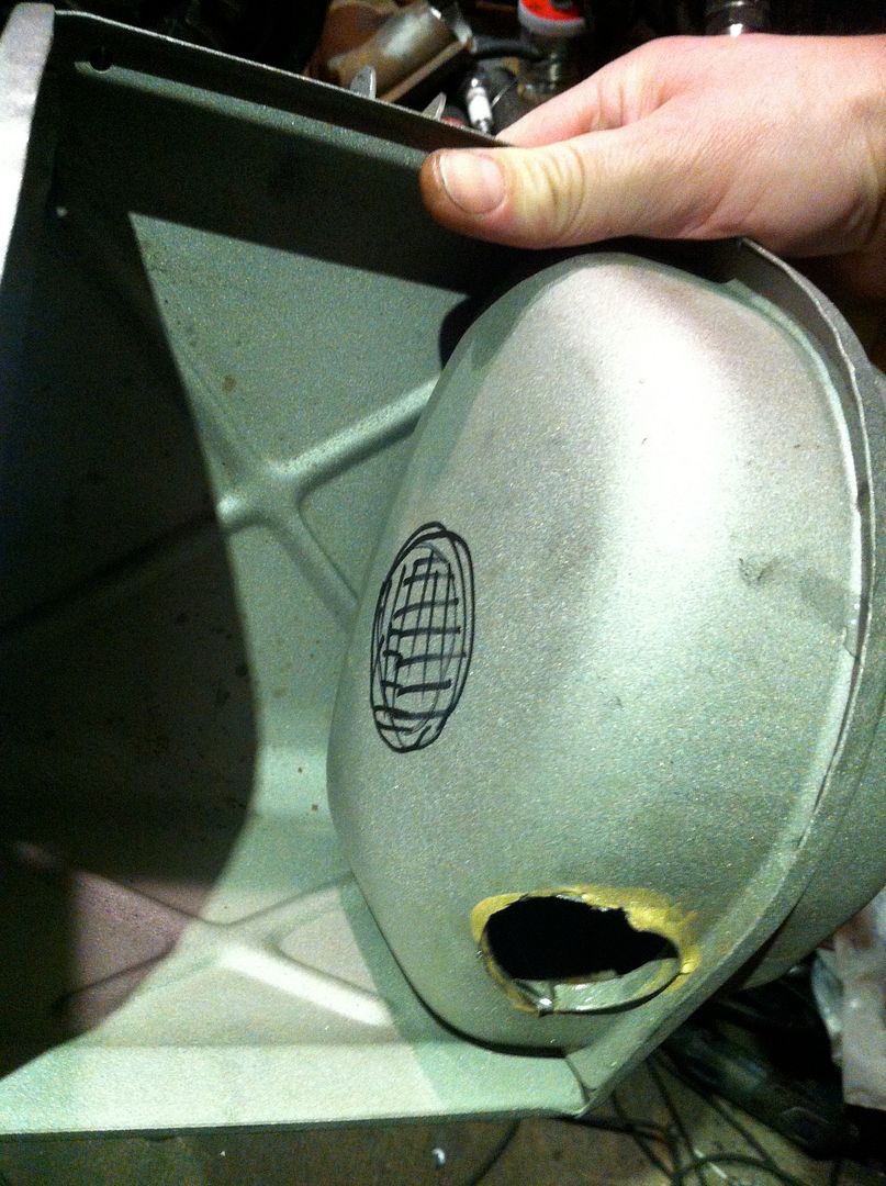

I'm thinking of an airbox tuning too. I have a serveta lince air box type One 3rd of the toolbox is occupied by the air system. A crappy restrictive sh.t.... But it calms down air flow before going into the air bellow. Like to keep this idea.
My idea is to take the toolbox room to put a real air filter and make in the 2nd chamber sort of a tuned box... Hope I'm clear enough....

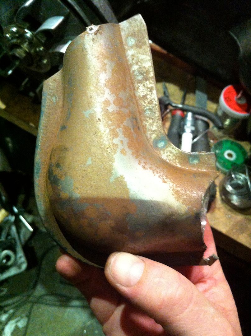

restrictor's out:
where I want to weld a tube of a certain length (to be calculated: 4-6cm??). Front hole will be obturated.
Filter in place:

Are you going to improve airflow in through the tool box louvres as well FF?
fastfrog
Posts: 412
Location: Paris, Taxes
coaster wrote:Are you going to improve airflow in through the tool box louvres as well FF?
yes i'll cut them wider...

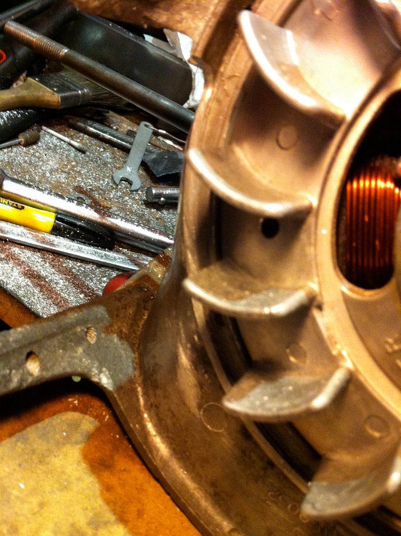

S-box ordered.
Meanwhile i've modified the maghouse outter lip knowing a lightened af flywheel is fitted.
