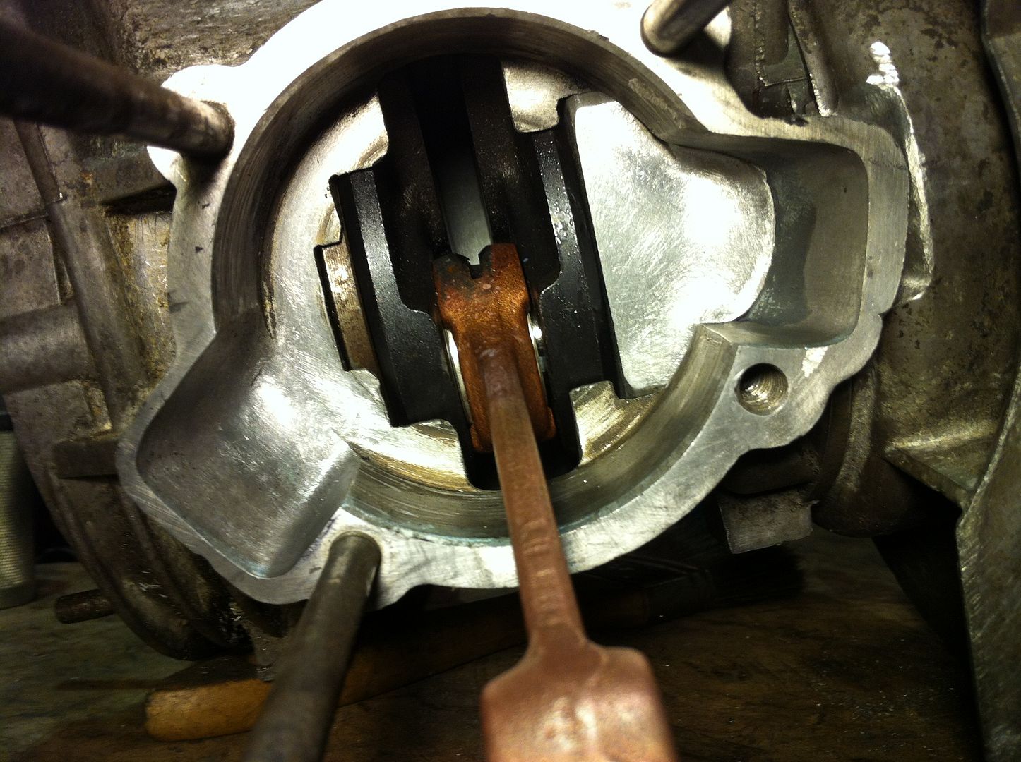

I took what was left home: Quiksteel. I usually take Loctite 3455 a bit liquid and hard to shape at the begining but afterwards it sticks like no other....
packer on:

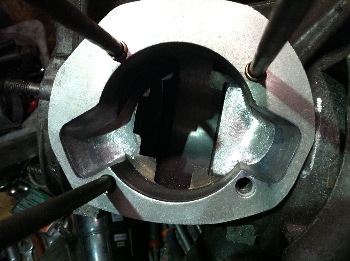

bearing, seals changed. Crank spins freely, no rubbing or stange noise:

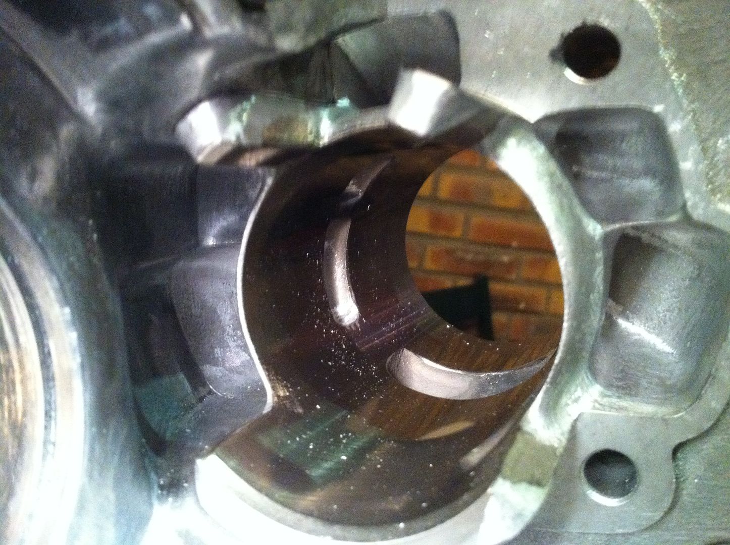

Timing checked with moulte accuracy:
T:125°
E: 152°
to get 180° race-base (http://www.race-base.com/2t-tools/steuerzeit/) says 7mm have to be removed at the upper edge of the exhaust port.
I'll stay <67% and get me a 45mm wide port
