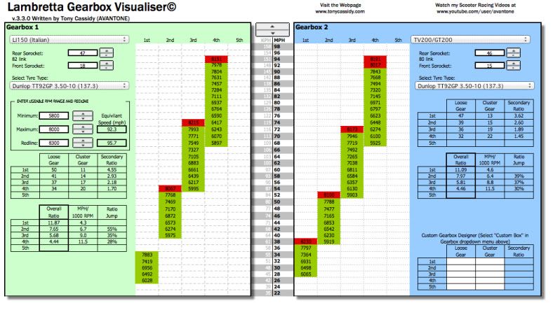

Avantone
Posts: 297
Location: Bromley, Kent
30+bhp peak and a flat torque curve should be good for 90 with a committed rider.
Li150 with 18x47 would get you up there and would give the clutch an easier time, but with so little power low down and no overlap it would probably be annoying round town.
TV200 with 15x46 looks like the best fit with 2k of overlap between the all important 3rd and 4th.
70mph @ 6100rpm with plenty left for effortless overtaking.

Avantone wrote:Image

Hi Tom,
Looking at the dyno graph, it doesn't start making power until 5500+rpm but then does so really smoothly until around 8000rpm.
The y-axis on the graph goes negative which gives the impression there's more area under the graph than there really is, and it doesn't show how much (or little) it's making sub 4700rpm.
If you want to keep the motor on the boil, ideally when you change up, your gearbox will allow you to pick up the next ratio without dropping off the power. The overlap is the bandwidth of rpm you can do this within. For instance with the Li150 box you can change up to 4th from 3rd at anything between 7600rpm and 8000rpm and hit that smooth torque curve, however if you changed up at 6500 you'd hit 4th at around 5000rpm and only 8bhp!
It's more accute with the Li150 box when going from 2nd to 3rd as to hit the power in 3rd you need to take it right up to 8000rpm with no bandwidth on when you could change (assuming you're going for it). The TV200 box is more forgiving in this context as you wouldn't have to stay glued to a tacho to get your gear changes right.

Hi Tony,
That's great, thanks for explaining this further.
