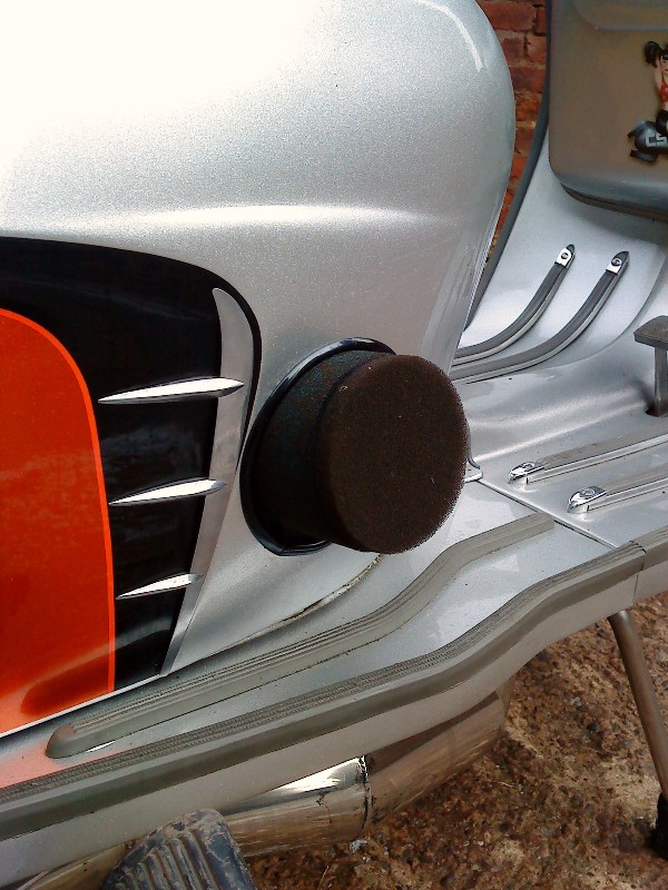

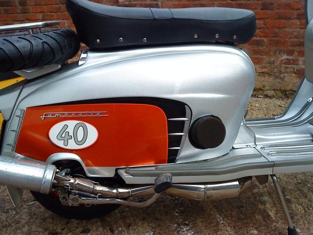

here is a few pics of cut outs in pannels

Thanks Yam-Lam for the photo's that's what i need , also need to get bit piping to cover the edge as well.

as you can see on my pics Ive used motorbike visor strip to cover any rough edges or bubbling on paint caused by cutting, it has it own sticking strip and sticks very well. you need to warm and work it in your hands before applying. its also good cover for when you cut your runners for your exhaust.....you can get it from hein gericke for about 12 quid
