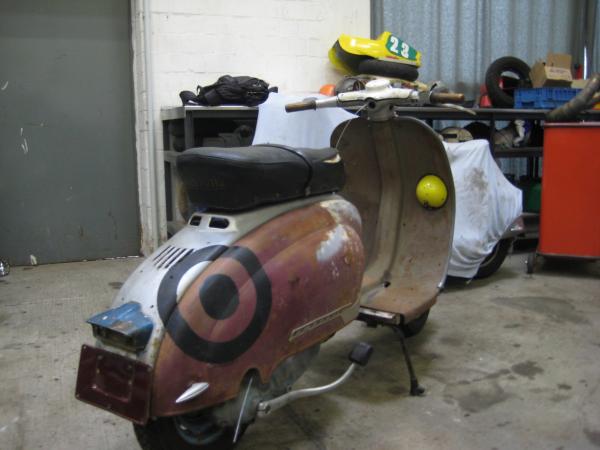

thats mine,same concept,different colours.
i like both.

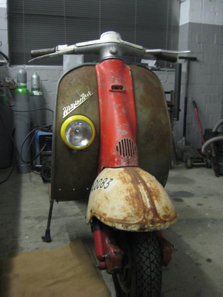

inna halle wrote:Image
i like both.
May I ask how did you manage to fit the lince forks into the series 1 headset without being too slopy? I did mine with a file and sometimes it gets loose (like everything on the scoot :lol: )
inna halle
Posts: 16
Joined: Tue Oct 13, 2009 6:37 am
you may ask,for sure.
its not a lince fork,it is a S.2 fork.i made up the brackets for the spanish mudguard which are welded to the fork like all spanish S.2.
the upper damper mounts are removable,again like on all spanish S.2.
the fat type damper are a tight fit inside the mudguard but it works.
Supereibar
Posts: 811
Location: Barcelona, ESPAÑA
inna halle wrote:you may ask,for sure.
Also its a framebreather! I love it mate, it really looks the dogs!! ;) :D
inna halle
Posts: 16
thanks.
yes it is a framebreather.
an old flatside dellorto breathing through the original setup on a reworked manifold.
its just what was lying around.
if i still had my cutdown auto thing id be blagging that race seat :D
