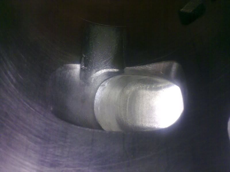

sean brady scooters wrote:On this one i have only cut one central boost, which is angled up to intake manifold area
which is mostly dont forget,all steel.
so it has not gone through to alloy..
even if you cut 3 boosts i still doubt you would go into the alloy anywhere :D
I will be very interested in your developments on this, rapido with a boost port. I have one I ported about 5 or 6 years ago, a 200 Rapido Classic, but I just havnt been able to put time asside time to get it finished and onto a Scooter. On mine I have the boost port opening a couple of degrees after the main transfers about 0.7mm below the mains in height, have you ported yours to open at the same point, before, or after the main transfers.
yes on this one the boost is set to open slightly after the main trans,by a very similar amount.
havnt got as far as final polishing/cleaning up and re checking with degree disc yet..

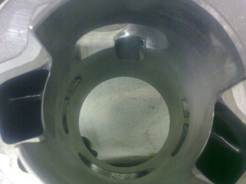

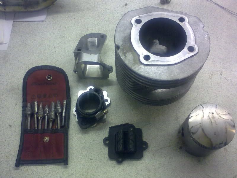

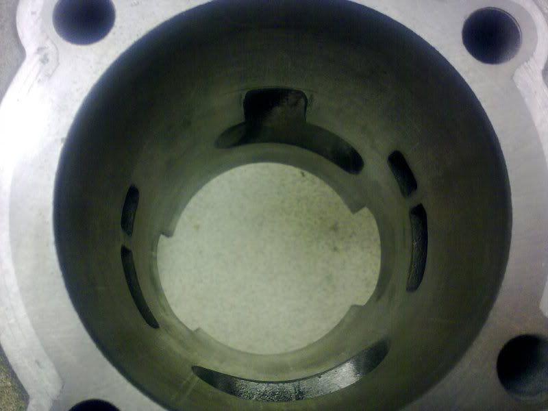

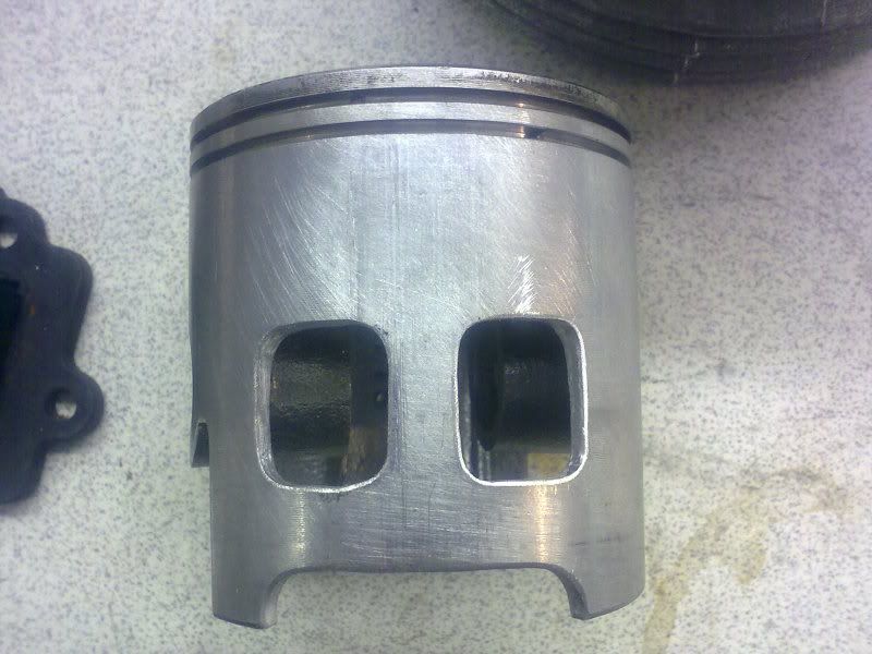

Popped into the workshop at the weekend and found Sean mid-porting on this Rapido cylinder. This is unfinished, but you can see the work thats been done to add a boost port to work with the LTH reed-valve. I think Sean opened up the LTH manifold as well to match the enlarged inlet port too. I think the exhaust was worked on too (Sean can confirm) and so after a bit of chamfering and poslishing this cylinder was ready to go. The standard Rapido piston was used also, with boost port windows added by Sean.
See pics:
You could also upgrade and use a TS1 piston on this, with wider ring peg gaps, so that the boost port can be made wider......but with the cost of the reedvalve, and then the piston, and then the porting......at what point do you just say......f@@k it....i'll just get a TS1??
