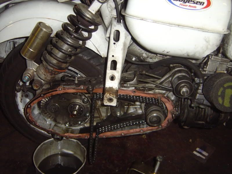

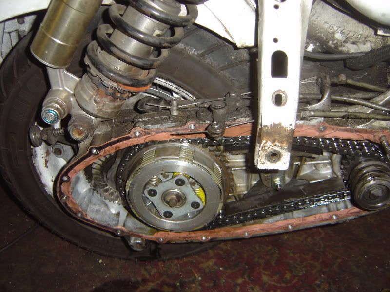

I fitted the clutch on Friday...
Heres some pics:
on my workshop persian carpet
Old clutch out:
New clutch it!
Here is the exhaust on my Series 1 that I am drybuilding at the moment:
Works in progress:

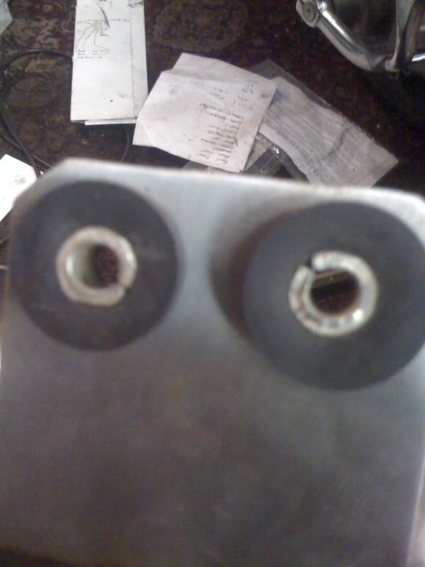

and here is a close up of the mounting brackets:
My comments on the clutch so far are:
The springs are far too hard! way harder than the MB springs I had in my standard clutch. Whats the point in having more plates of a better design if you are going to have really strong springs????? My first task is to source some softer springs!
Also, the clutch engages/disengages really early in the lever travel which takes a bit to get used to... not sure why its hard to get used to as my Moto Guzzi clutch is the same!
Anyway... more to come after I source some softer springs!
Cheers,
Christiaan
you might want to try pit/monkey bike spares for springs epay might yield something
Dryballs
Posts: 333
Location: Stockwell, London
Righto I've been playing around with the clutch this week...
First time out I wasn't particularly happy with the clutch! the springs were really hard, it was noisy, if you pulled up to the lights in gear it would rattle sometimes and a couple of times the clutch started to slip when giving it beans!
On Monday I pulled the clutch out to check out why I was getting grief
I think my problem came from the springs - there is no way to seat them properly on the pressure plate (lambretta pressure plates have recessed holes to locate the spring) I think this was why it was noisy as I released the clutch and why it slipped sometimes. I sorted this out and changed my oil back to SAE90. I did make the mistake of refitting the standard clutch nut because it looked better quality than the one that came with the kit! This meant that the lever didnt pull all the way in - the pressure plate was hitting the nut. I also noticed that the top pressure plate was rubbing slightly on my kickstart shaft (I rectified this with a grinder on the incriminating part of the kickstart shaft)
Also - even with better suited oil and the springs seated correctly the clutch was still awfully heavy to pull. I was also having trouble getting into first gear at the lights, but I think this was more due to the clutch nit hitting the pressure plate.
I pulled the clutch out again today (I'm getting f@cking good at this!) and changed the clutch nut for the (2mm) thinner nut that came with it. While I was at it I changed my gear cables and clutch cable for nice new ones... I also changed my clutch lever and my existing one (original to the bike since new) as the hole where the lever bolt goes through was completely worn out in to a huge slot!
So these few maintenance items have made a huge difference to the clutch - its a lot more cilky smooth to pull, releases easier and doesnt seem to slip - although I only had last night to quickly have a blast around and see!
