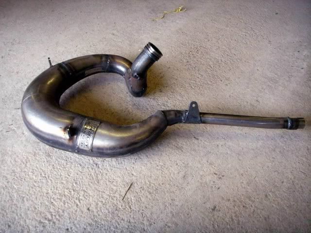

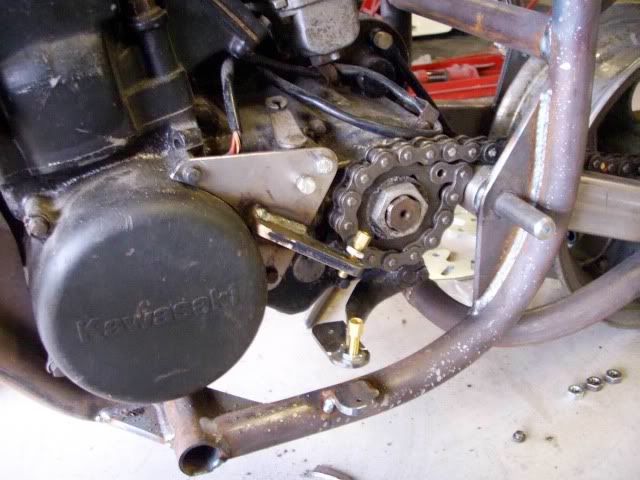

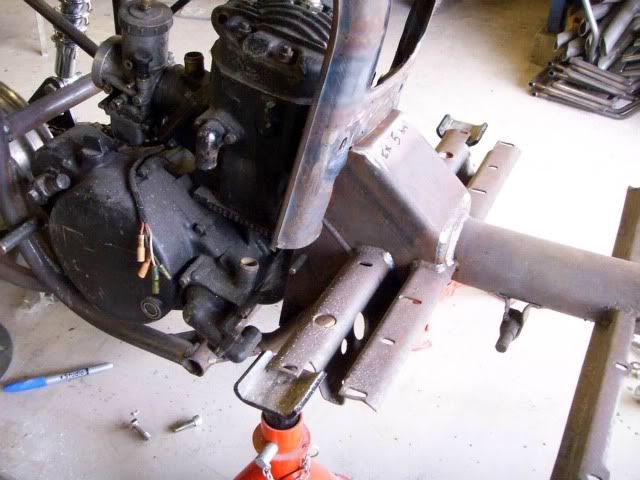

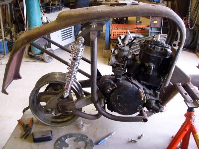

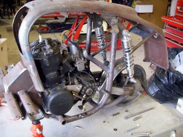

Hi all, just a quick update: I had a few pictures from our Frank. One of my big stumbling blocks was trying to find a new after market exhaust. Because the bike was more than 5 mins old it is had to get parts for. I had to get an exhaust made for it in the end. Pro-pipe in the states made one for me in the end. £189 including p+p. So I shipped that off to Frank for him to fit. Not an easy job he says. The panel work has been ordered and should be here with in 2 weeks. I got an order from Scootrs £400 worth. All good quality it would seem, the drops are really good, the rim fits really well. I had all the graphic done at Scooter Graphics, cheep as, as well. I should get the scoot back from Frank before Xmas I hope, in a rolling chassis, forks fitted with double anti dive discs. Then starts the long slow re-build, paint , powder coat etc.
