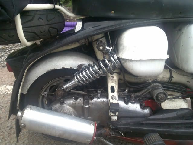

My RI Shock snapped tonight

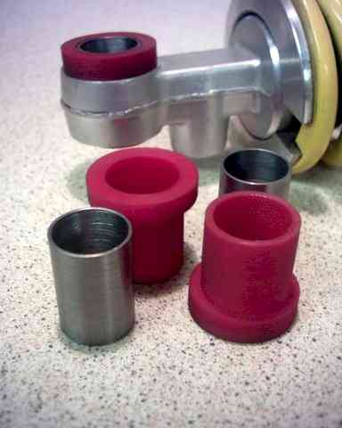

in original spec one side of the R1 shock is mounted solid and the other is mounted on needle bearings and a race.
i had thought about trying to find bearings to fit, but hadn't bothered.
lloydy came up with a steel sleeve slightly longer than the bushing that the nut tightens against.
http://www.smellofdeath.com/lloydy/imag ... ushes3.jpg
more can do, less doodoo.

You might want to consider that this metal fatigue failure is not down to the mounting bushes but actually more to do with the engine mountings.
The Lambretta engine rotates not only around the engine mount bar but also side to side as the engine twists over uneven surfaces and during acceleration and breaking. This side to side movement is not taken up in the solid R1 mountings and therefore stresses the metal, essentially it is the shock that is attempting to hold the engine straight. The R1 shock never had to deal with side ways movement because the swing arms all run in bearing, nice an colinear, not exactly like a Lambretta.
The only way you'll get round this is to either 1. make an elastic rubber bush for both ends of the R1 shock or 2. work out some rose joint system if someone sends me the the internal dimensions of the shock mounting (ID and length) I could sketch something up on CAD and post it up for a rose joint solution.
The other option is solid engine mounts, and have your teeth rattled out (not really a good look).
