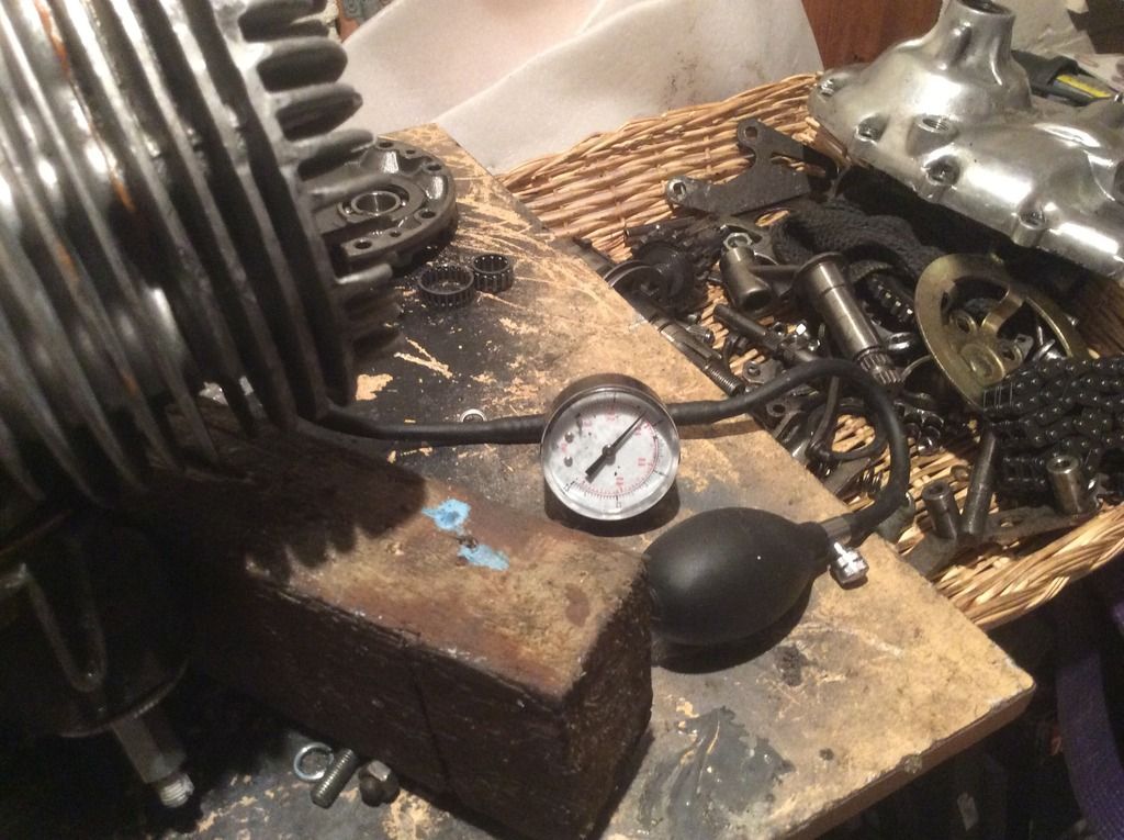

alanscottj
Posts: 960
Tested mine on a Mugello 186 that I'm building, works great, just the slightest of leaks to find :roll:
