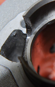

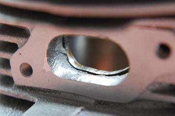

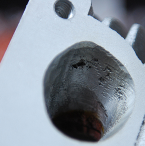

As promised, I've received the barrel today and here are some pictures, please lat me know if it is ok?
I see many grinded part and also some gaps....
Thanks

Give it to Harry Barlow to wave his die grinder over and turn that cow's ear into a silk purse.
I gave him my a rough SR190 cylinder (very similar to the above) and was very pleased with the quality of workmanship, end result and was charged a very reasonable amount too.

Well I'm very happy. I gave him the cylinder and a tracing of the (opened up) crank case gasket face gasket area and what I got back really was very tidy, the work to the transfers in the cylinder being most apparent.
It's fitted to my SX150 with a clubman, PHBH 28, suzuki piston, mec long rod crank and is very smooth and torquey.
