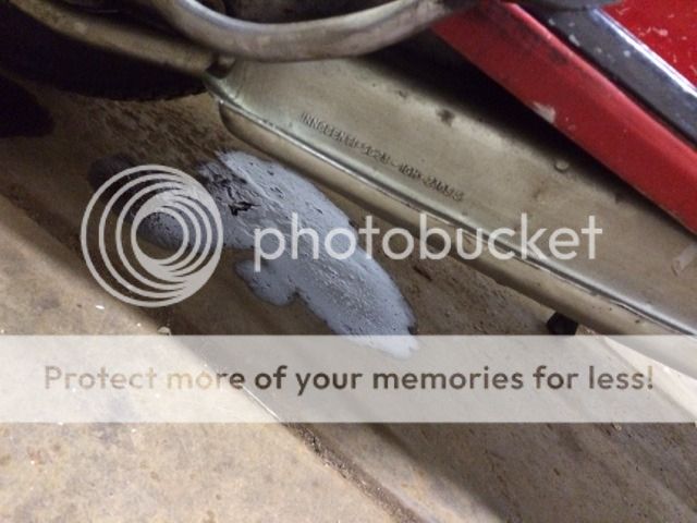

two stroke dripping from my mag house joint??

this is how much oil pissed out in 48 hours !!!! it looks like two stroke, slightly red but if its coming from the mag housing gasket its leaving a serious oil slick!! i still use the scooter and iits running ok, the strip down will happen in october but ive never had a leak like this happen before...

your finger appears to be covered with NEAT 2T- i.e. not mixed with petrol. The mess on the floor appears to be normal petroil mix?
Where do you keep your 2T bottle?

Are you sure its not leaking from somewhere else and dripping to a low point ?

that is a hell of a pool of oil for 48 hours....it does look like neat 2 stroke?? my oils in the glove box but thats dry. im going to check the petrol tap, if theres a leak from the tank would the petrol evaporate leaving just the two stroke??i couldnt see any obvious leaks above the base of the maghousing engine block, this mystery may need a Miss marple approach....

alcoholic maniacs sc wrote: if theres a leak from the tank would the petrol evaporate leaving just the two stroke??i ..
Yup ;)
