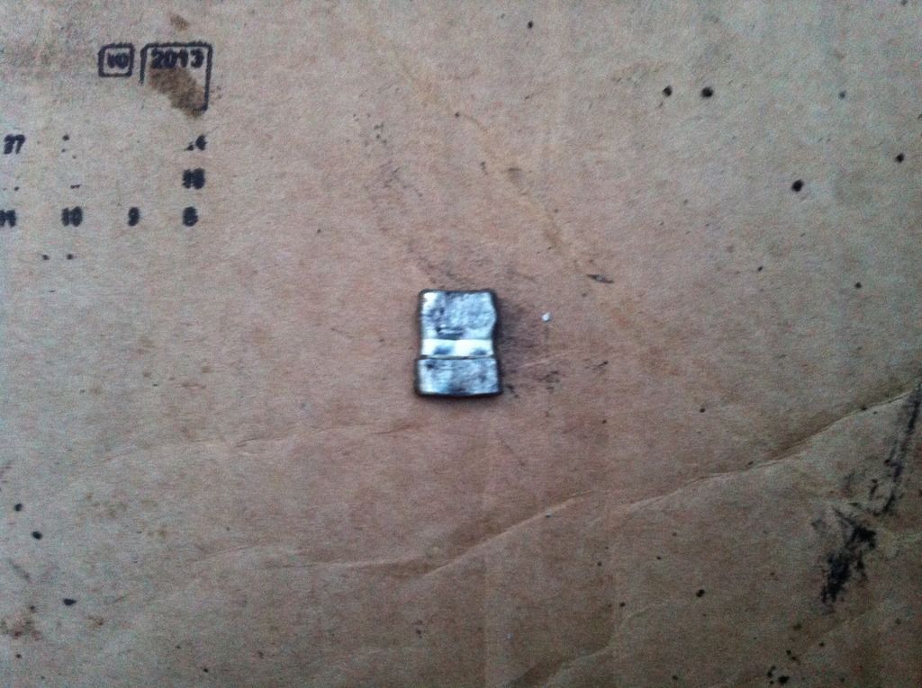

The conclusion is somewhat simpler. When I took the head off this fell out...

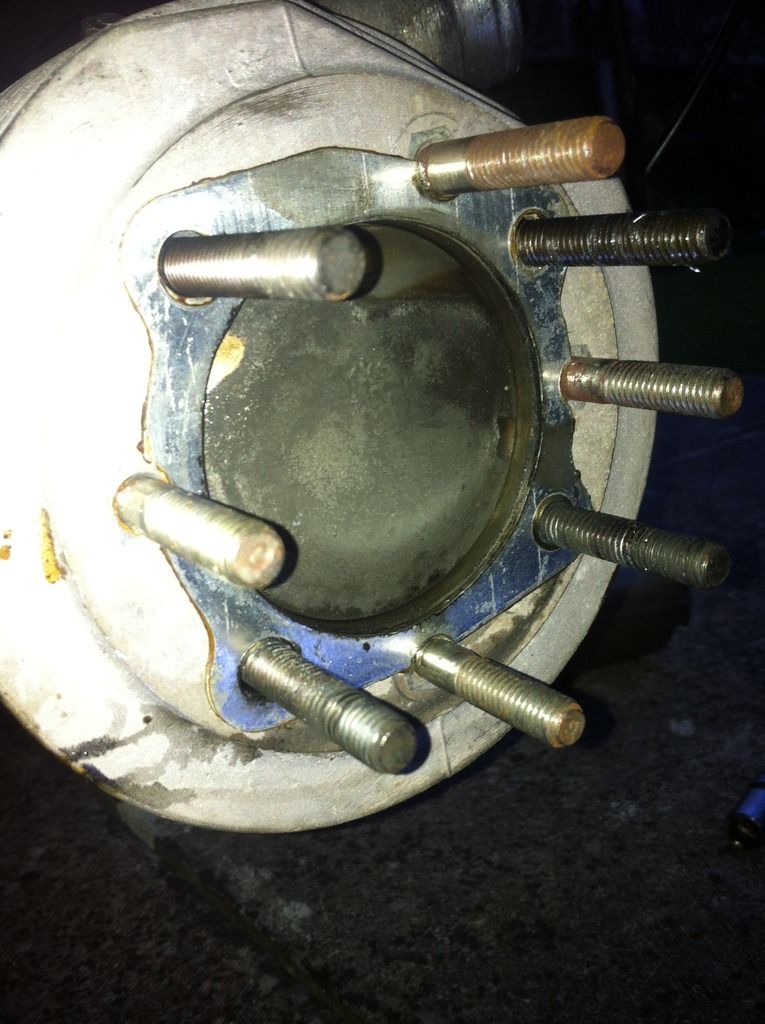

At first I thought it was an electrical connector but then realised it was the nipple off the spark plug! It must have fallen in when I took the plug off. I wondered where it had gone...!!! Four of the nuts on the head were loose so it was probably letting air in so it's a good opportunity to rebuild an decoke the piston as well...! Cruddy...

No !!!!
And after all those brilliant diagnosis we all gave !

Heh! Good news for me though... my only expense will be a tube of silicone!!!
