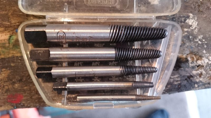

Tim, there is a product to remove snapped studs/bolts, I think you would ask for a set of stud extractors. I have a set but can't find them to post a photo but basically they are a rev thread cone shaped item. The principle is you pilot drill the snapped stud then wind in the extractor until it's tight this then starts to unwind the stud as you continue tighten. I've used these to some success but I would seek an alternative to removing this stud. Is the exhaust a Clubman type with the bracket for the hole you have blocked and a clip towards the end? If so, I'd get someone to weld another clip to the pipe and fit it to a side casing stud. The chances of removing the broken stud without damage is a big ask, then the chances of it vibrating loose will probably see it long gone before you notice.
I hope your well, it's been a long time my friend. All the best. Dave
thackers
Posts: 198
Joined: Wed Jan 07, 2009 11:54 am
Location: Harrogate
Found them
