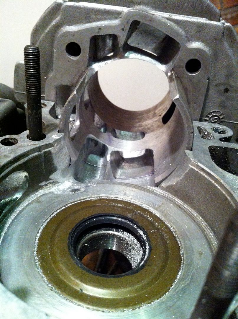

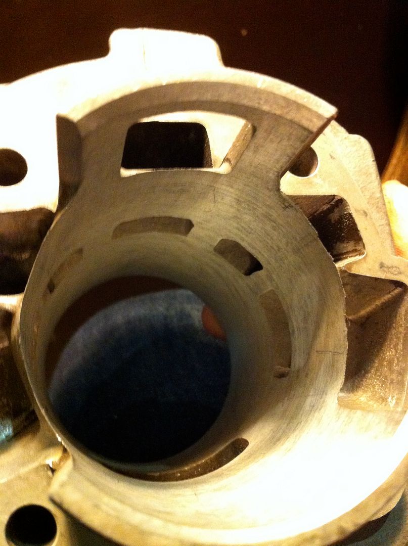

doing the case job:
Size matters!

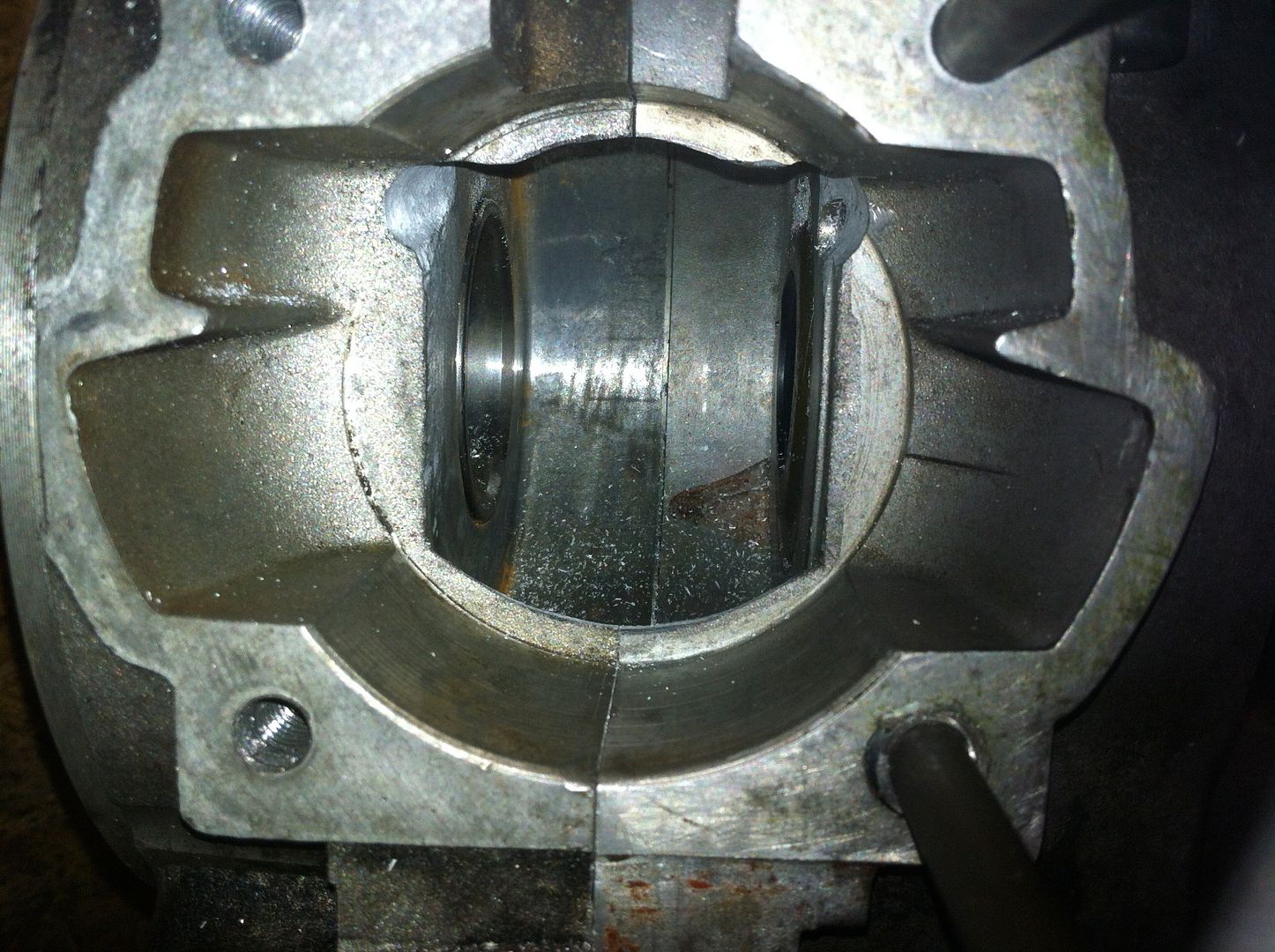

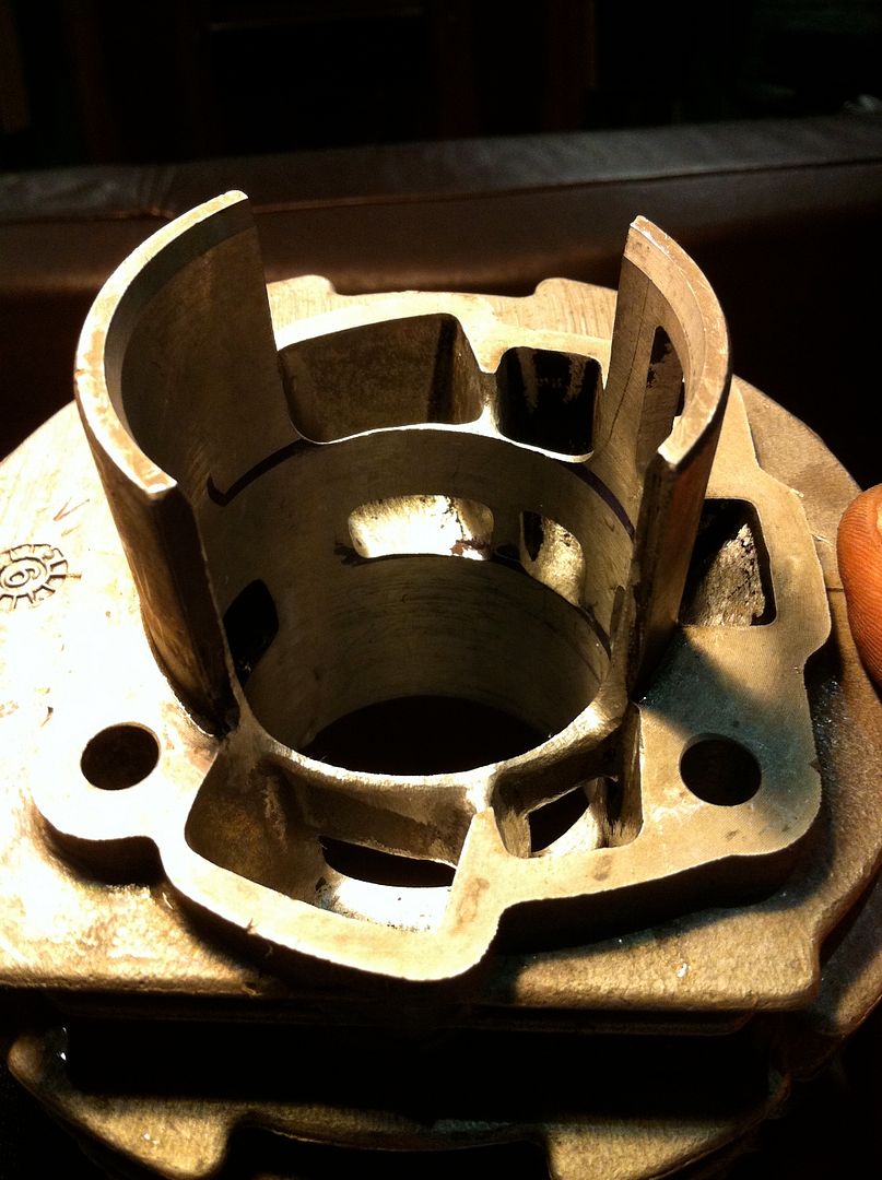

A bit further:
Size matters!

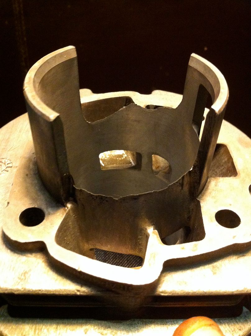

barrel's back from boring.
No much meat left on the transfer walls.... I'm a bit scary :?
Size matters!
jackson85
Posts: 33
Joined: Sat Nov 23, 2013 1:35 pm
Main scooter: T5mk1
Not much meat left there frogger
fastfrog
Posts: 412
Location: Paris, Taxes
no but that's not high pressure risk area
Size matters!

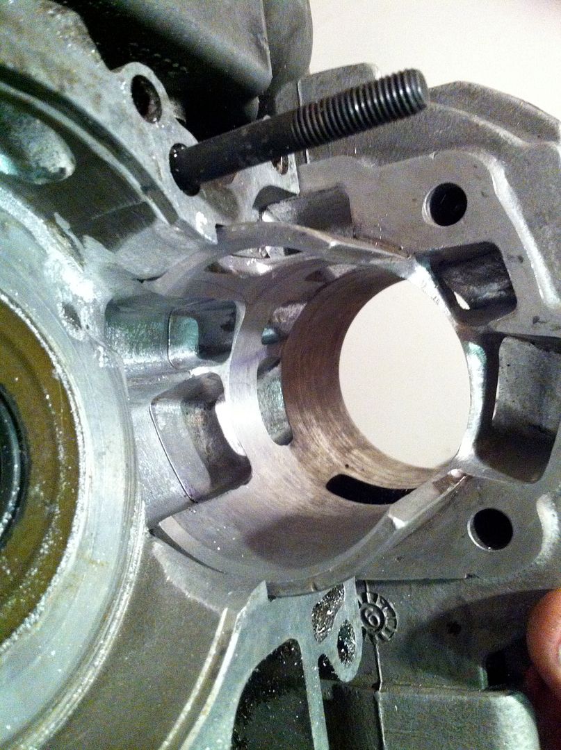

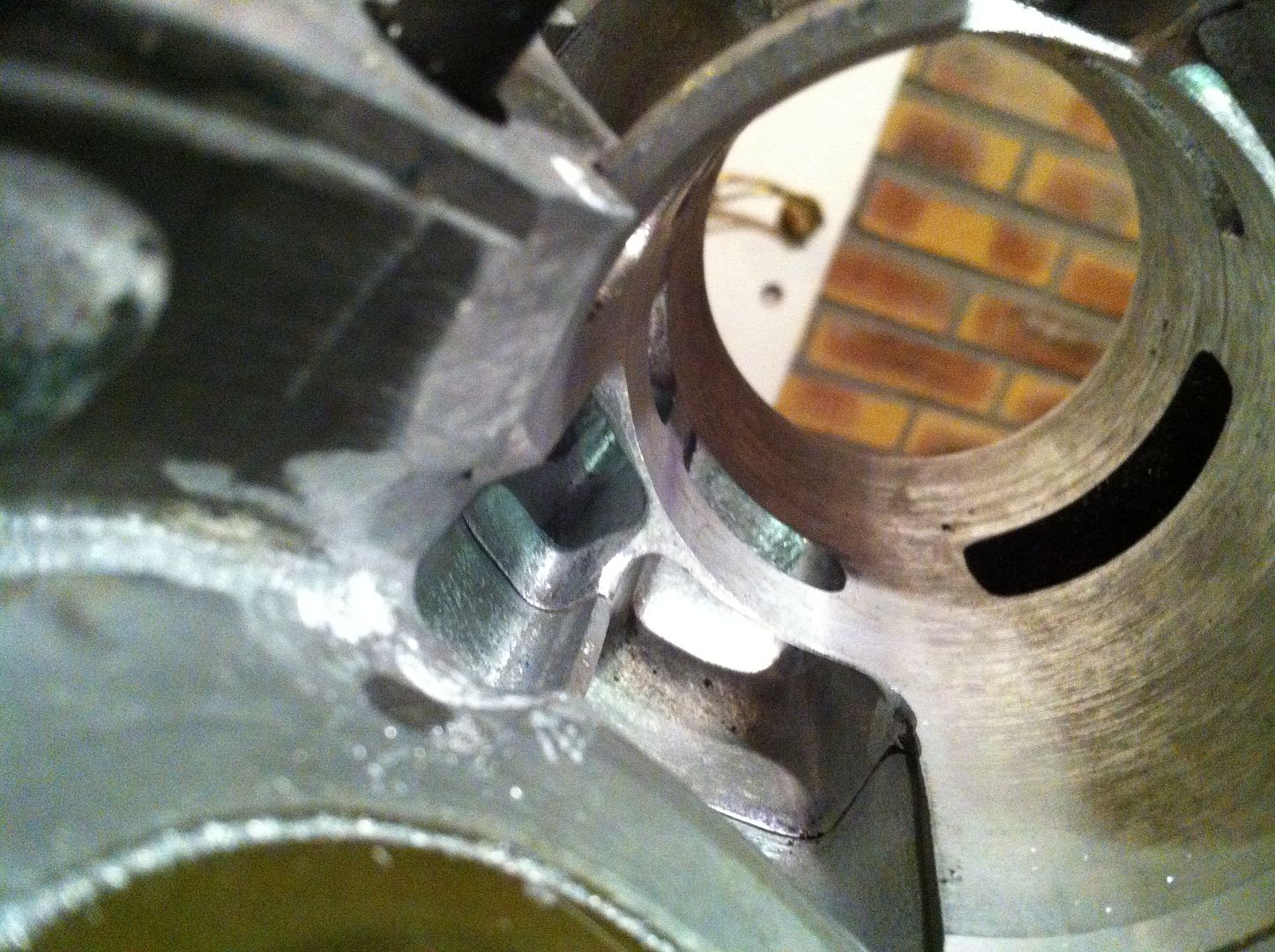

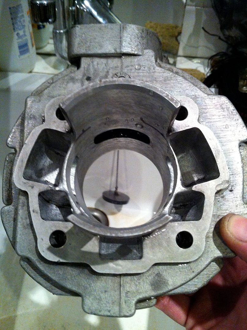

porting job on its way:
feeders:
Size matters!

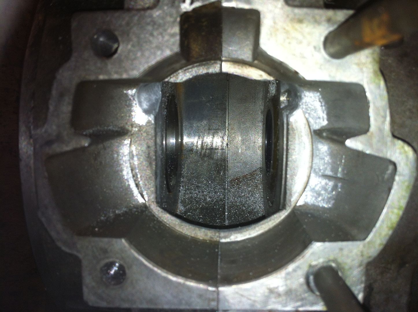

2mm packer in place.
Barrel replated.
Size matters!
ducksta
Posts: 1129
no change to crank then :?:
