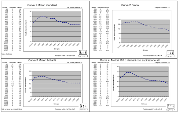

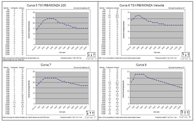

Could be usefull to choose one of thoses curves ( 3or 7 ;) ) as a good first step:
