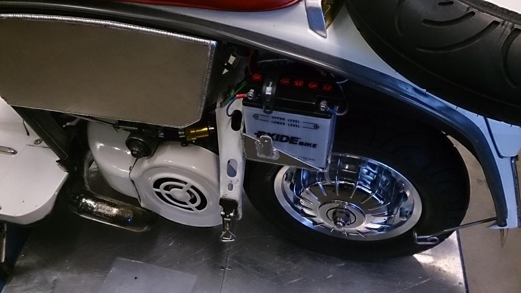

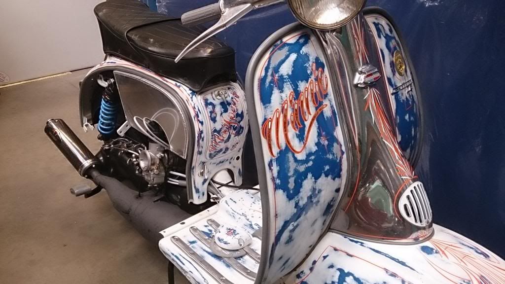

Here is one of our Tanks for Dave "Madness" on his latest Project. It is a one off at the moment, as we are only producing Tanks for Series 3's. Series 1 and 2 Tanks to come shortly.

hydra wrote:
rosscla wrote:Do oiltek do one with a toolbox?
To be honest, we haven't given any thought to a Tank with a toolbox within it, it would reduce the fuel capacity too much in my opinion. Inside legshield toolboxes are better and carry more, again, my opinion :D
Image[/url][/url]
http://www.oiltek.co.uk
Yes must say Paul's done a very nice job on this tank thanks again mate. 8-)
