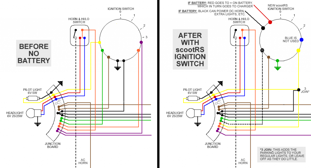

Here you go (click on the pic to see it full size):

Nerdy Norm wrote:Here you go (click on the pic to see it full size):
Thanks for that, it looks perfect!
