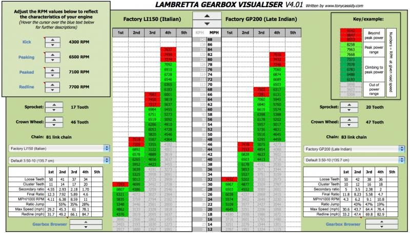

Both OK but I'd say getting the gap between 3rd and 4th is way more important than the gap between 2nd and 3rd.
On that basis GP200 with the preferred bigger crown wheel looks better IMO.
GP200 vs. Li150 gearboxes:

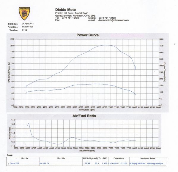

The graph on this particular GT186 shows a peak power of just over 20HP.
With the GP200 box, changing up from 3rd to 4th at 7000RPM brings you into 4th at around 6000RPM and approx 18HP. Peak power is then within 500RPM and holds until 7100RPM and 75-80 MPH with a 20x47XGP200 (83 link chain) final ratio 4.7.
Stock GT186 Dyno Graph:

Avantone wrote: Stock GT186 Dyno Graph:
When you say "Stock GT186 Dyno Graph", are you sure the motor is a stock GT186 with no work whatsoever 'cos that's damn impressive and nowhere near what I've seen from a stock motor previously? :-?
I grabbed a dyno sheet off of Lambretta Images for the power delivery profile rather than ultimate output.
http://www.lambretta-images.com/archive ... WhDcmS9Kc0
I wouldn't have thought it too hard to achieve though.
If the profiles right but the outputs optimistic, then GP200 is probably still right but with a 19t sprocket.

Avantone wrote:
Ah right, I think this one had some work, I was starting to get small penis syndrome :-D
