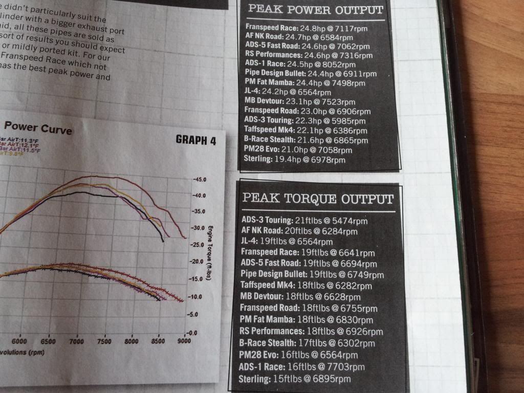

Darrell Taylor wrote:also dig out the ts1 exhaust test feature from a year or 2 ago
Anyone know exactly which issue of Scootering their latest TS1 exhaust test was in, where I think one of the NK pipes came out on top??
Thanks :)
twenty eight
Posts: 60
you ok tom
ts1 test no 297 march 2011
cheers rob
