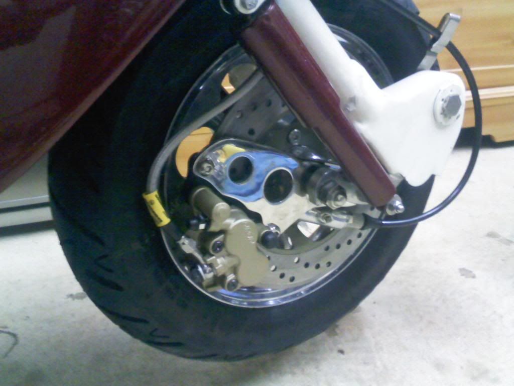

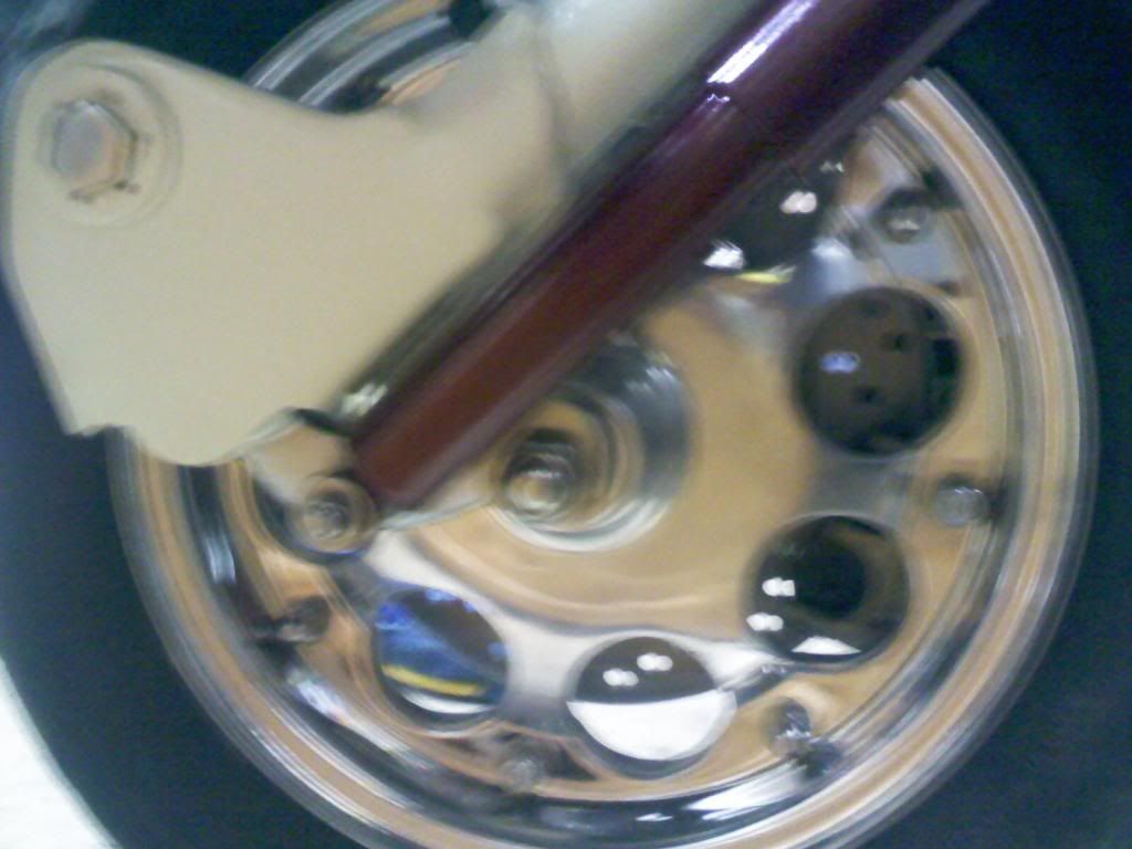

heres mine ive got polished hydraulic master cylinder and lever , stainless braided hose , polished hoses fittings i paid £315 delivered for my kit
to finished it off im waiting for chrome bgm dampers
forks are not bent just took picture of my mobile in garage at funny angle

simonwwfc wrote:heres mine ive got polished hydraulic master cylinder and lever , stainless braided hose , polished hoses fittings i paid £315 delivered for my kit
seems alot , I paid £230 for pepperpot version same as yours, polished hub, stainless hose, nissin components from KBR scooters Doncaster
