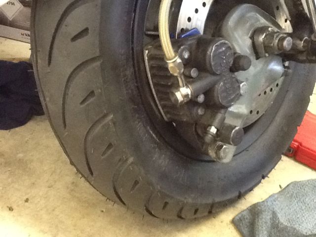

Would it be ok to space the wheel out away from the hub or is that just dangerous?
Mel K
No clearance and this is with washers between the rim the hub which I don't think is a good idea. :?

Yes I had the same issue on a mates scoot with an MB disc with sip rims, I had to grind quite a bit off the caliper to get them to fit.
Mel K
Hi Carlos Fandango, I reckon on about 10 mm coming off? Is there enough there to do that? Really want to use these rims but don't want to change the hub as it works perfectly. Thanks for your input.

Got MB disc and SIP rims. I did need to file the caliper, but not much at all, just about 1mm.

Mel K wrote:Hi Carlos Fandango, I reckon on about 10 mm coming off? Is there enough there to do that? Really want to use these rims but don't want to change the hub as it works perfectly. Thanks for your input.
I just put masking tape on the rims and ground just enough to get them to fit on, id guess about 5mm. My mate said he wasn't bothered if he had to have a new front Disk brake if it didn't work, so I wasn't to worried about grinding away . I got about 1-2mm. Clearance. The biggest headache was getting the old studs out, as thehex heads had been ground down to next to nothing in order to miss the calipers in the first place !!! Leaving about a mm. of head to get a socket on !!

Thanks for all the input, grinding it is then, I could also take a bit off the fixed pad to gain a mm or two as the new pads move it all closer to the rim too. The hub studs are done thanks to Captain Pugwash and his heat gun and lock nut one side and ground down socket the other, method.
