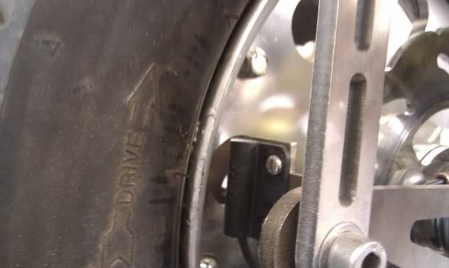

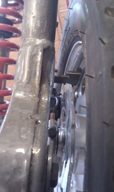

Heres mine, I tig welded a small bracket to the caliper hanger. Then drilled and tapped a M6 thread in the what would be the hub.
The thin cable was then threaded through the speedo drive and up a standard Lambretta speedo cable into the headset.
